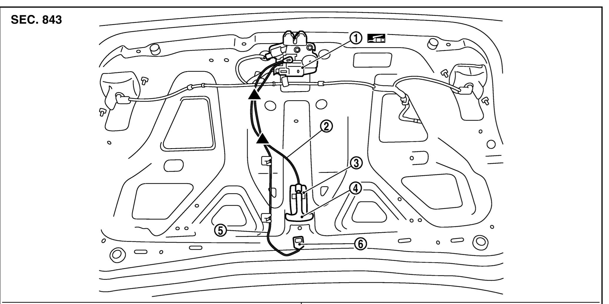

There are two emergency releases, one is a glowing pull handle in the center of the trunk lid and the other is a small black finger sized pull near the pass through. See #5 & 6 in the 1st pic and #4 & 6 in the second.

And this is definitely on the 04 sedan? If so, thank you you are a lifesaver, because I haven't seen anything else on any other forums talking about that, everyone just says green handle green handle, well mine broke lol. Now to see if I can reach it.
