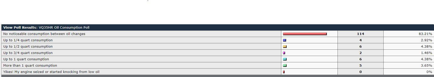

Originally Posted by Pbfoot
I'm curious. My DE uses no oil yet the HR is known for it. How does that make the DE unviable?
Proper preventative maintenance and no history of abuse can provide better life.
The DE's horrible record comes from IT being the first generation placed in a RWD Sports/luxury vehicle.
It all starts with spark plugs or misfires. We can all agree that most wont address these on these cars in a timely manner. Cat's start to deteriorate and once that happens your air fuels richen.
Misfires can happen due to fouled plugs due to bad gas or leaky VC dues to cost of replacement. Lets say you fix your valve covers however the oil already weakened a coil that gives a random misfire. This will destroy the cat. once that happens your air fuels richen.
Once your air fuels turn rich, you'll finalize your cats and either you'll replace them with cheap ones or keep riding like this. We can all agree that OEM cat replacement is not a cheap one whether new or used. and We can also agree driving with a p0420 is not a worry for most.
That's until the richer airfuels slowly glaze the cylinder walls, this in turn will leak some compression into the crank case giving you the famous oil in the pcv issue, most dont discover this until later, that oil will be mixed back into the combustion chamber and lower your final octane making your plugs take the toll.
Just because your engine has not given you these issues doesnt mean it speaks for the rest, my DE had no issues when I purchased, Many nissan oem NEW parts later she decided she wants to burn oil.
The data doesnt lie, this was a poll created by this forum.
Around 17% of people report 1/4 to 1 quart oil loss between changes yet 83% report little to none.
It's your turn to search how many DE member suffer from oil consumption and you can make the determination for yourself.
