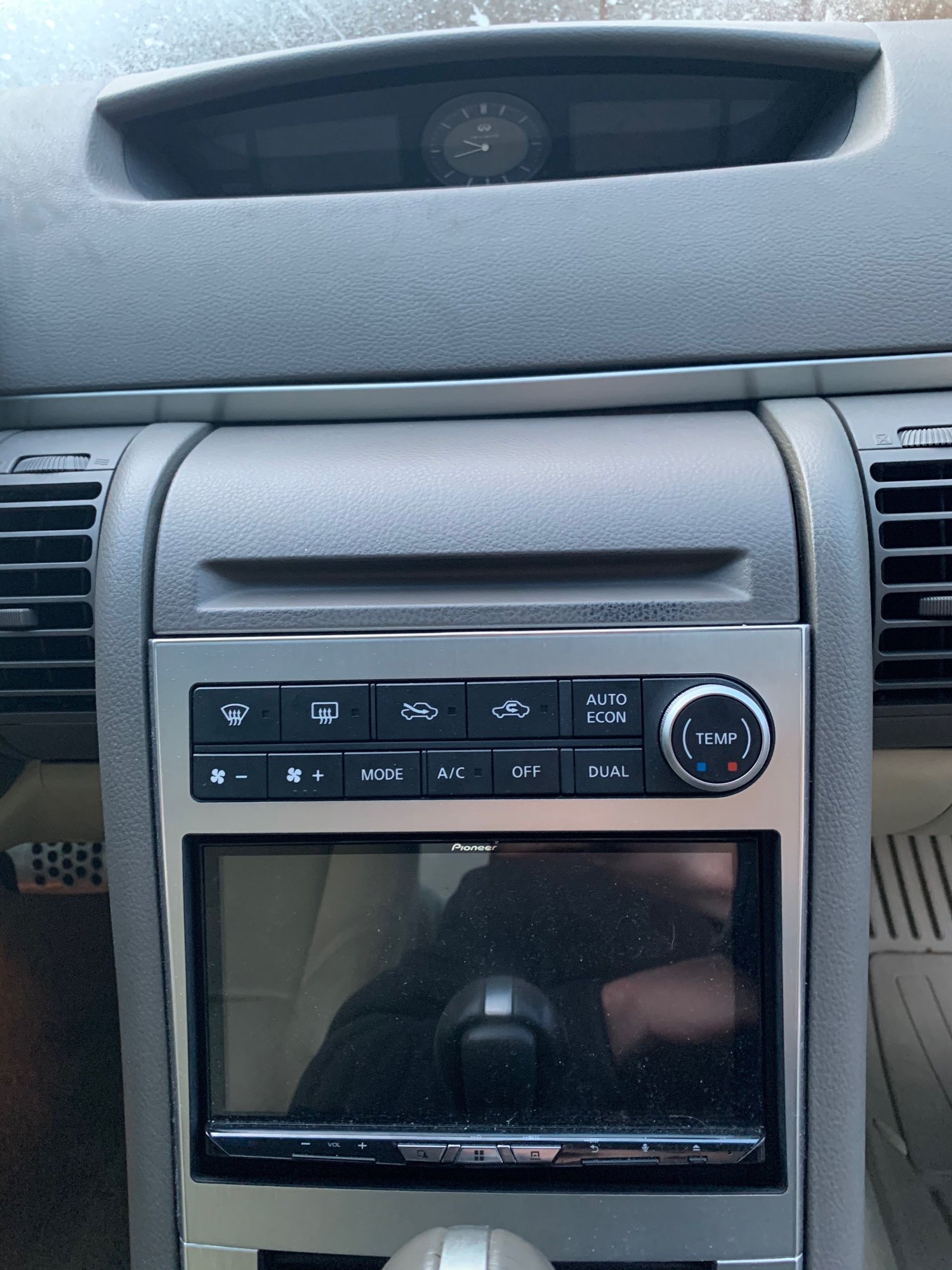

Confirmed, did it with mine. I really like having the extra storage space to put my phone or wallet inside while driving. Don't forget to remove the Nav DVD drive and get the glovebox insert to replace it for even more storage! (but don't expect much) I have one sitting in my closet waiting to be installed on my car so let me know if you need part number. If you are planning to do this just know that the brackets for nav and non nav radios are NOT the same. I found this out after I got the job done and now I have a gap that looks like this...
So before you do this, make sure you acquire the radio brackets from a non nav G radio. It looks this way because I believe my installer guy had to drill holes in my original bracket since the holes didn't line up right. I remember having the part number saved somewhere but can't find it right now. I had to end up buying an entire radio assembly on ebay for just the brackets. So you're best bet would be looking for junkyard G's and see if they will part with just the brackets... (most don't want to would rather sell the whole unit)

I guess the radio bracket is different on the 05-07 radio with nav. On my 04 with nav, I just took the screen out and nav buttons off 2 Phillip's, iirc) and used those screws to put a non nav dash pocket/cubby in. It fit the brackets with no additional work and lined up like OEM. Also gutted the dvd from upper glove box and put the storage insert in from a non nav coupe. Not much real estate gained, but I cut a small hole and used a rubber grommet to pass through my amp's control panel on a hinge, so I can keep my wheel lock and a flashlight behind it in the little storage spot.
