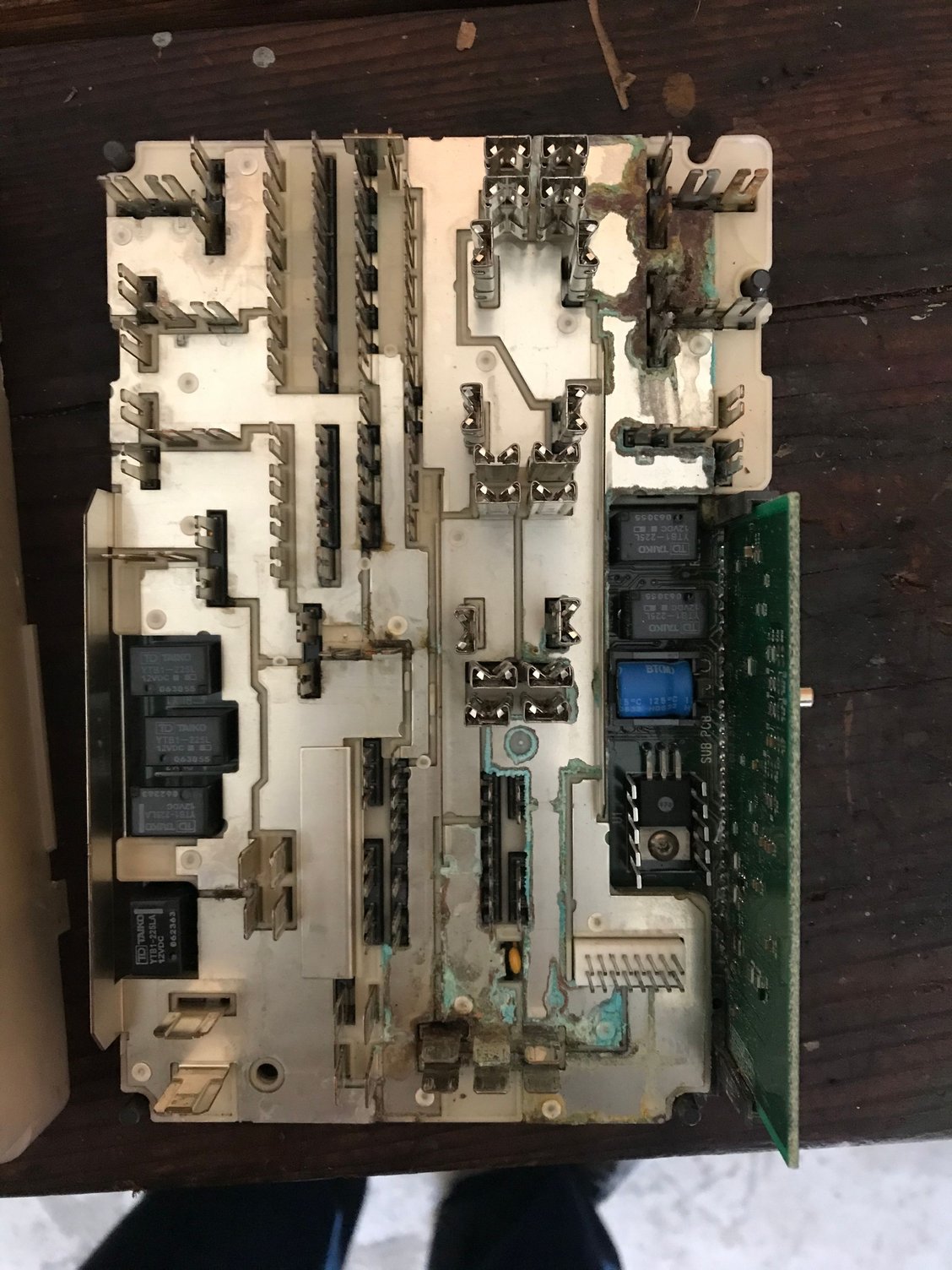

Hey everyone I recently got a g35 coupe. Long story short purchased car with not knowing extent of some problems.
im in need of help and advice.
1: taillights aren't working
( even with new fuse, it keeps blowing)
2: headlights aren't working ( tails,blinkers, headlights)
3: trunk realest buttons is not working along with the vdc button. I have no power going to them. Any idea?
4: can I use any ipdm that's from a coupe to replace mine? Mines looks like this.
Ipdm that was in my car could this be the problem to my concerns?
I have read about changing all the fuses and whatnot, but nothing has happened. I got some second hand headlights and still unable to get them working. I've replaced all fuses and some relays. Before one headlight would light up if I locked or unlocked car. I believe one of the relays was ticking, I changed it and am still unable to get them working. I've read something about the ipdm I've gotten another one but haven't hooked up yet. Any advice on what I could do please let me know. At this point I'm thinking of using a toggle switch to turn them on.

Yes you will need another IPDM from the same chassis, I don't know if the package options all had different IPDM, like if premium package with the sunroof had a different one but I assume Nissan would use the same IPDM for all coupes to save manufacturing cost.
I would start with a new IPDM and go from there, fortunately it's just a plug-and-play component. Just be sure to do any electrical work with the battery disconnected.
It will PROBABLY fix your headlight issue, however I'm betting you have broken wires in the trunk wire loom that is causing the brake light fuse to trip so you should also open up the flexible conduit section and start looking for broken/shorted wiring. You'll probably also find broken wires for the trunk release.

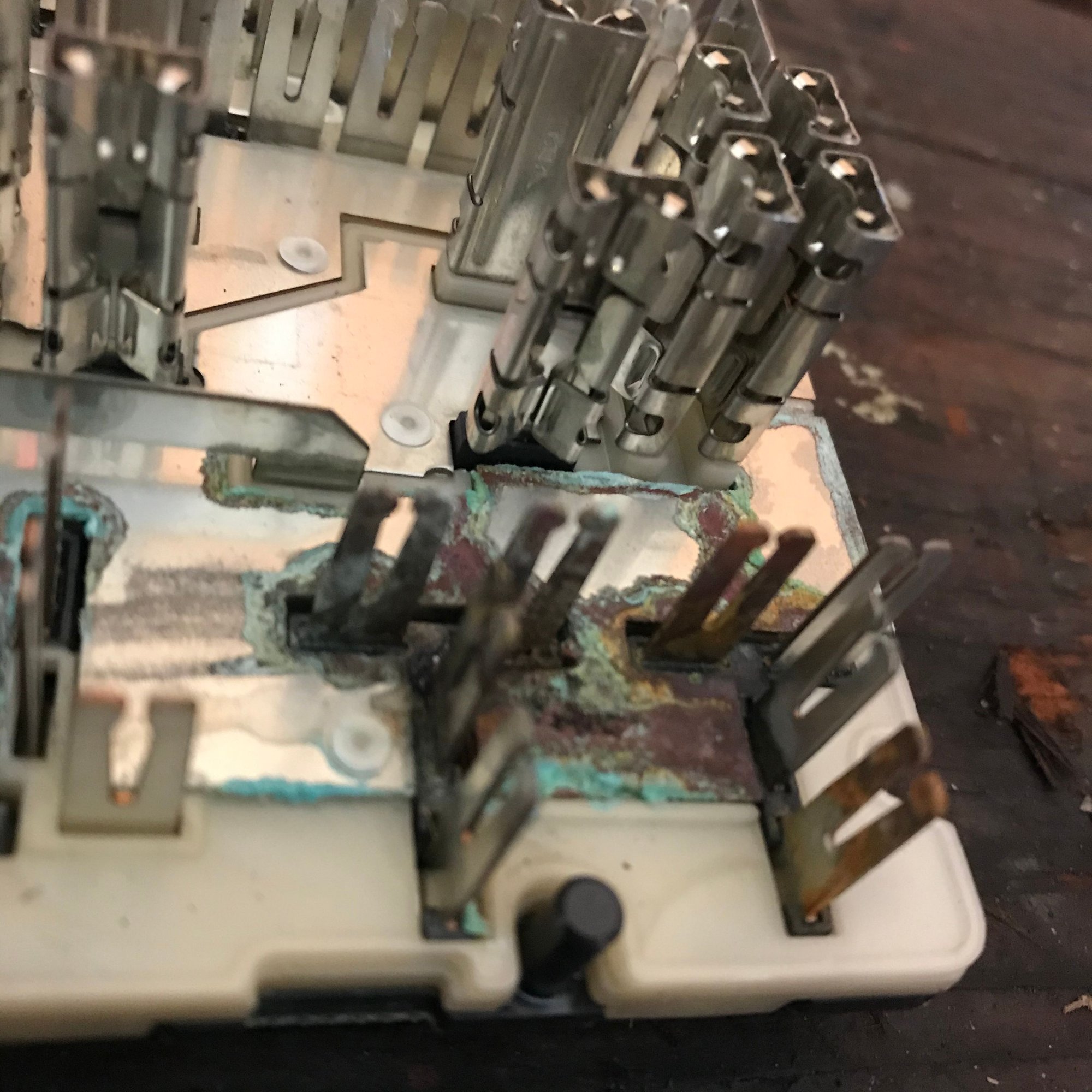

Ya that IPDM is toast.
I know cleric said it didn't matter but would u happen to also agree it doesn't matter what ipdm I use just match the year. The one I got was from a auto
Old Feb 4, 2020 | 06:13 PM
Scorpi0's Avatar
Joined: Feb 2018
Posts: 3,087
Likes: 445
From: LA, Cali
The only thing different between the years that was controlled by the IPDM I can think of is the daytime running lights. I know the 06/07 had different circuitry than the 03-05 models. But Im not sure if they changed the internals of the IPDM to accomplish this, or if they just changed the wiring downstream of the IPDM.
Maybe someone can compare schematics for us and verify.

so I got a new ipdm well a used good one and yet my wipers and headlights still are inop.
when I lock the car I can see passenger headlight blink like any other car. But when trying to use turn signals and headlights I get nothing. You guys have any idea? Also still can't get into my trunk unless I crawl through back seat.
