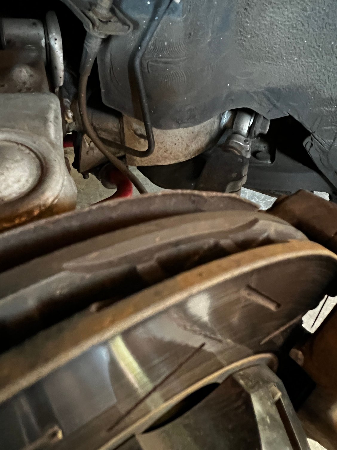

I put the car on jack stands, removed the wheels and snugged down on the lugs. Without the wheels I'm still getting the vibration coming from the same rear passenger side. I did notice that the rotor hat looked as if it had a bit of very slight off-axis movement. I put the wheels back on because I needed the car today but I'll investigate further. I'm leaning towards ordering some new bearings even though the ones I have on only have about 12k miles on them (same as cv axles).

Found it
It turns out that I had a chip in the inside edge of my rotor. These are the two-piece rotors from z1.
