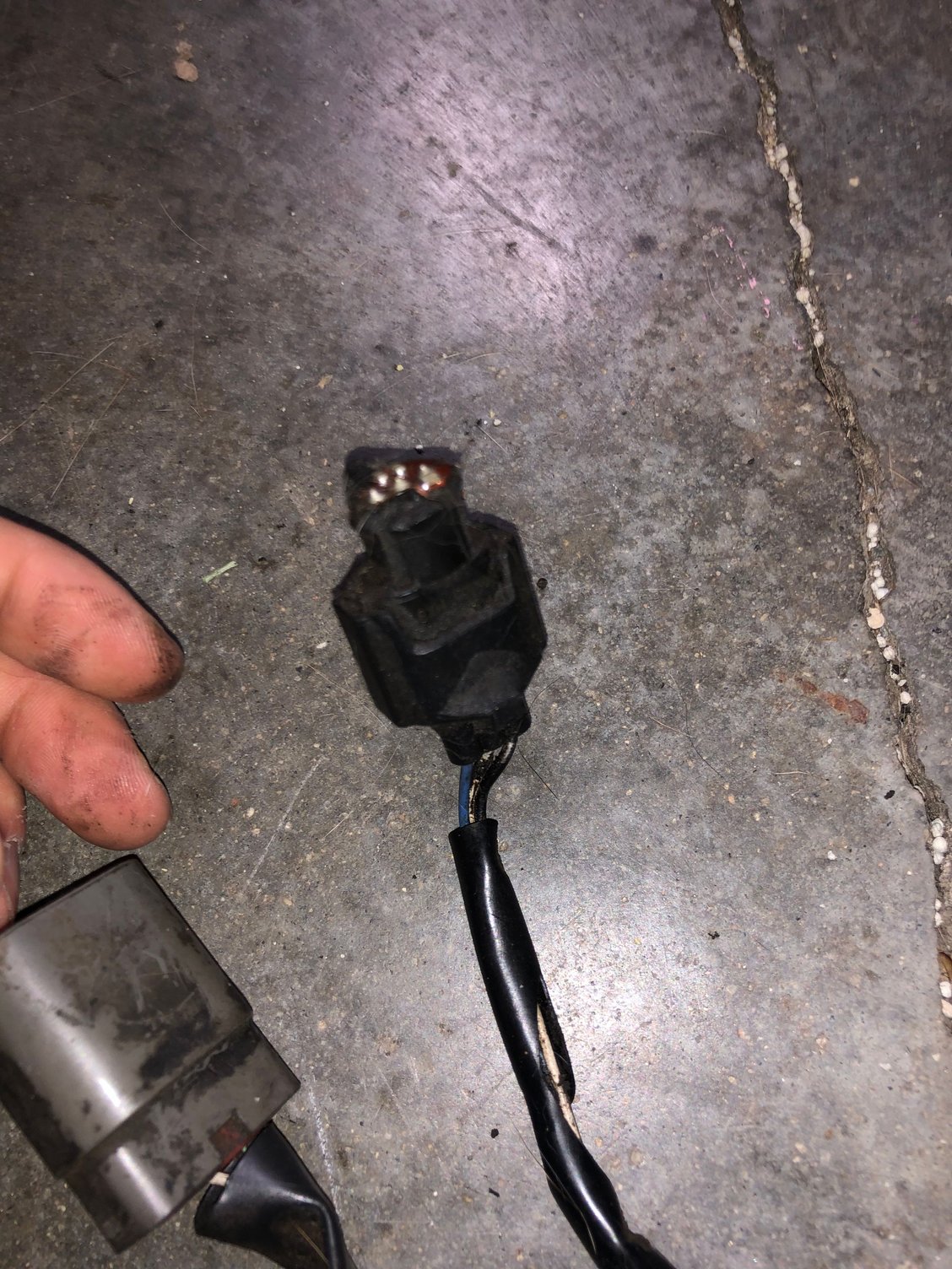

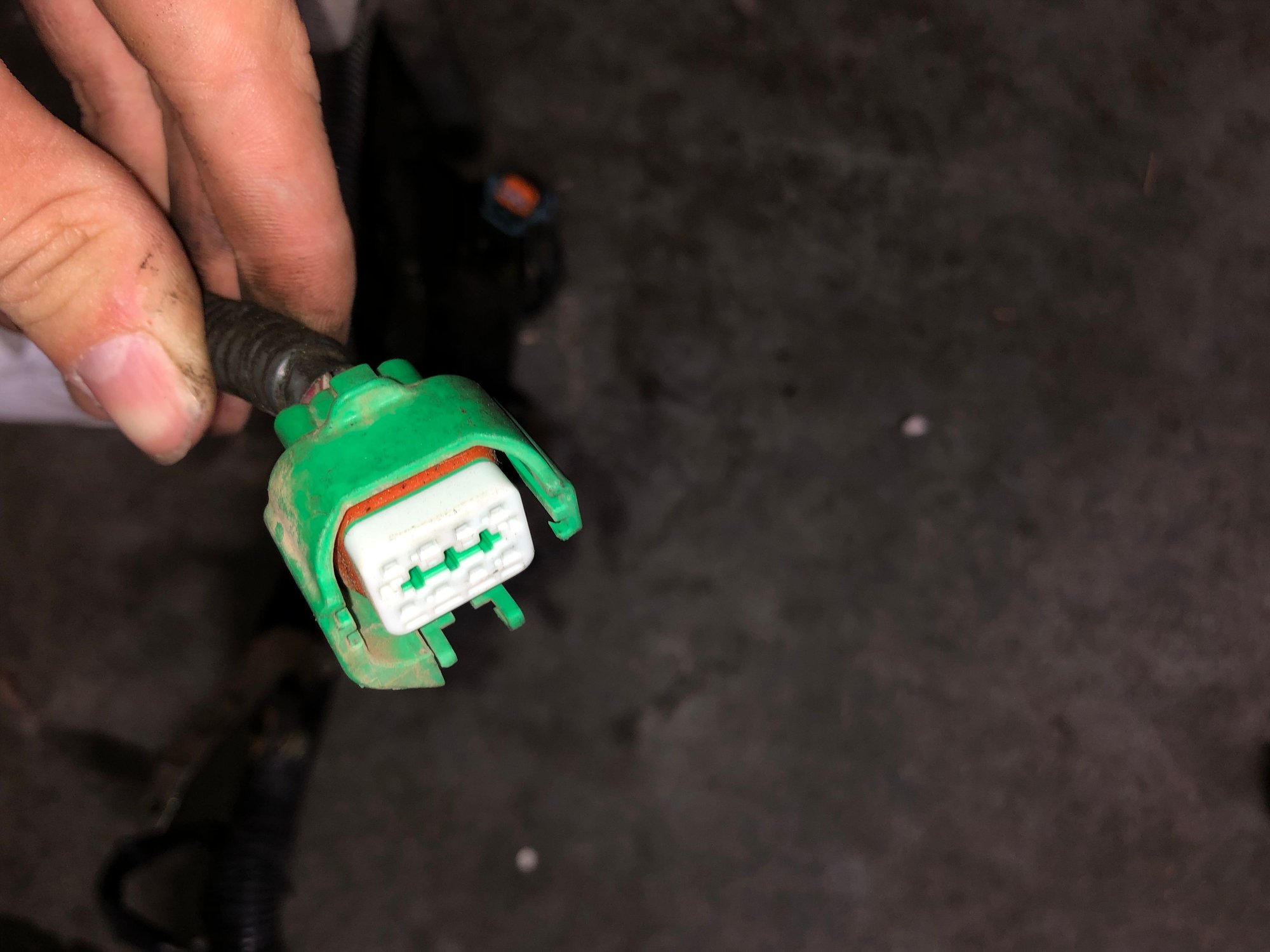

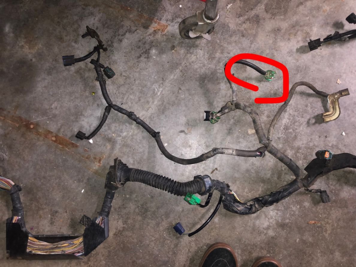

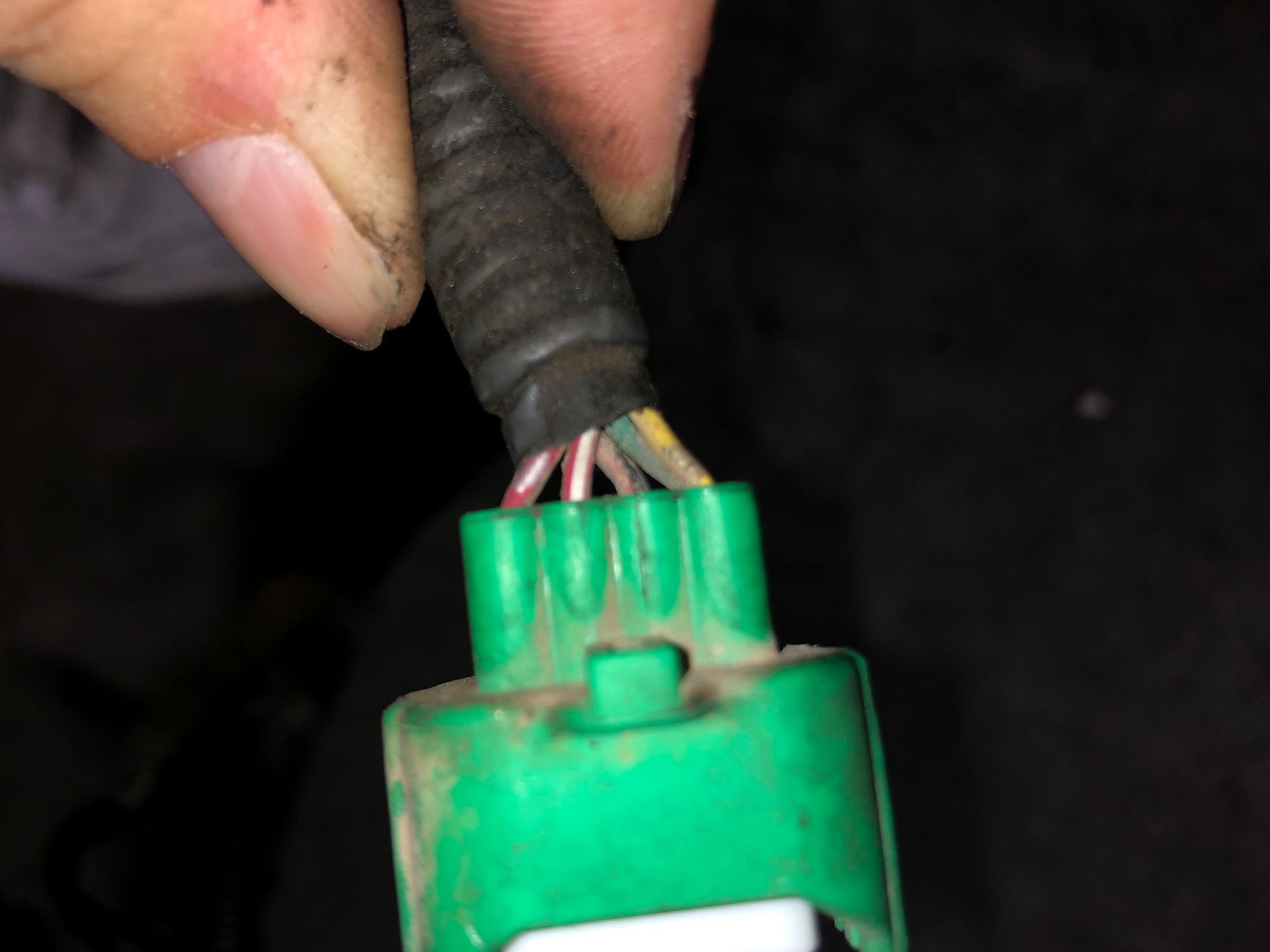

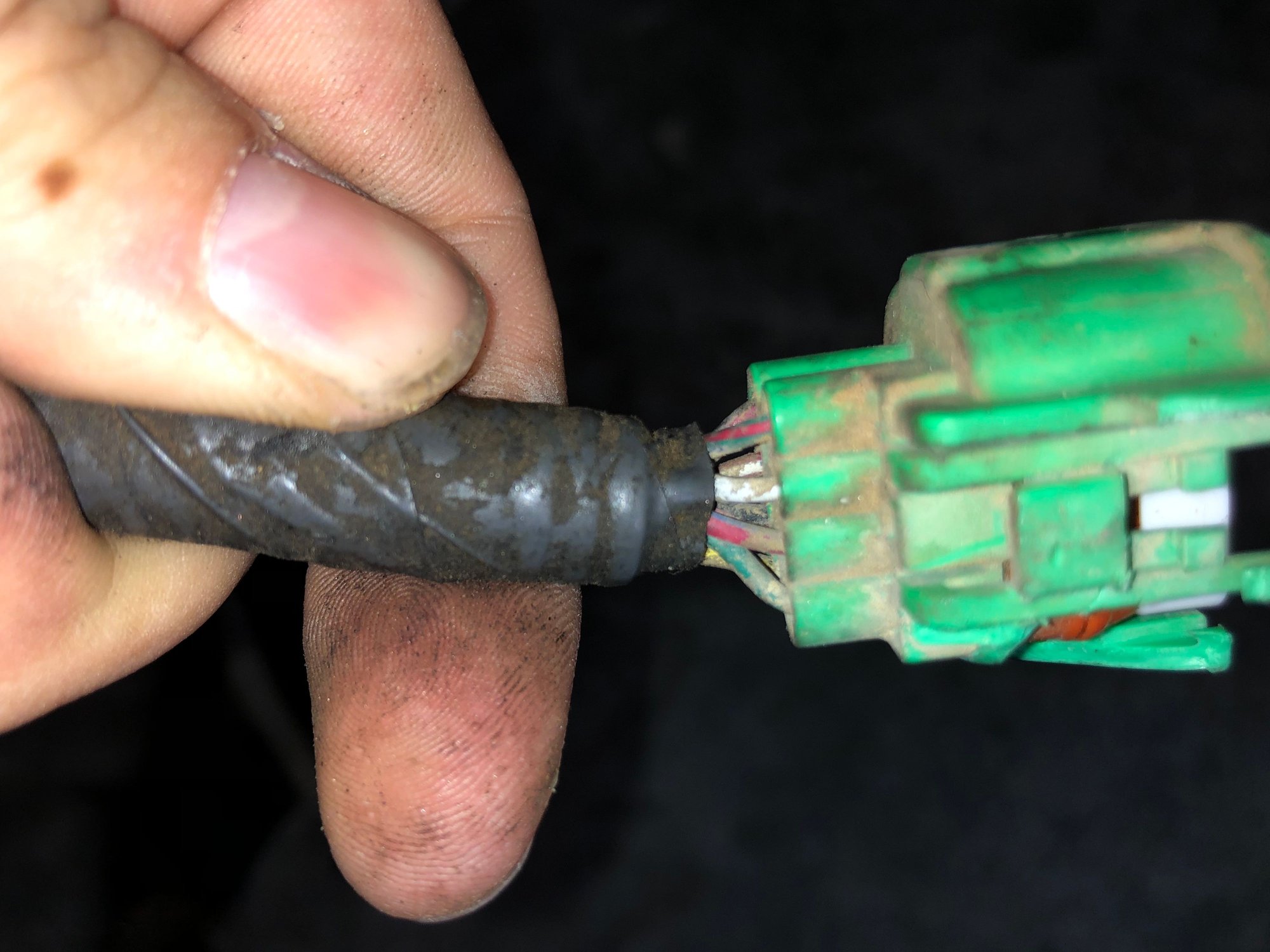

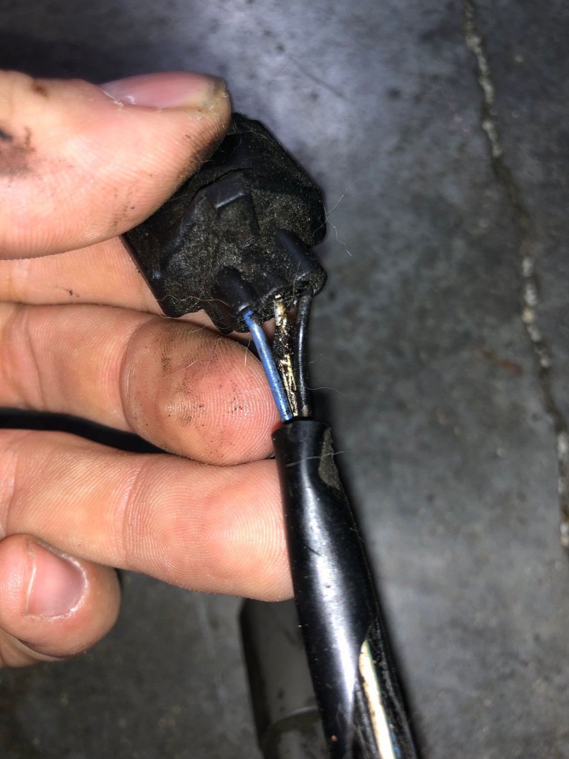

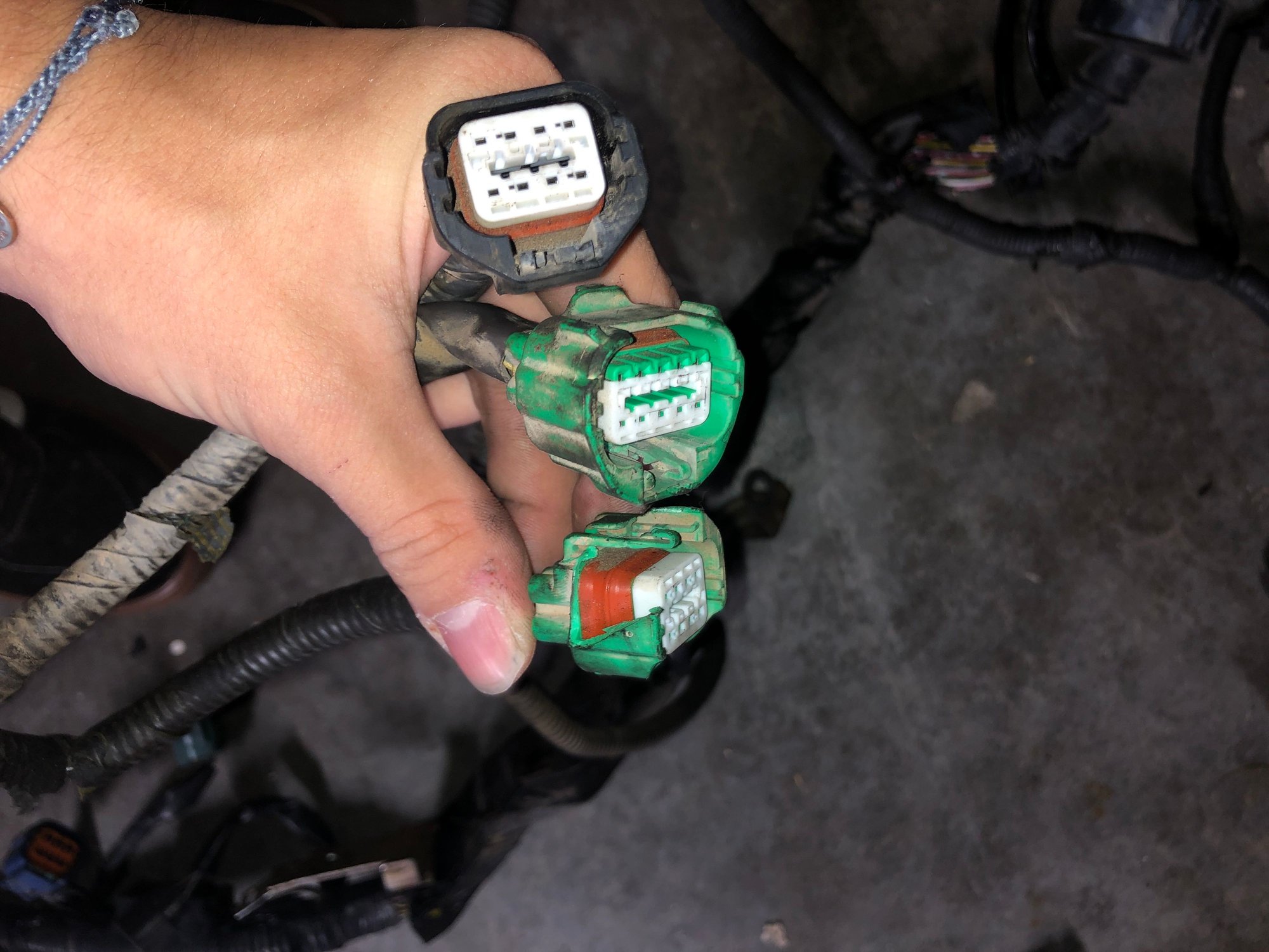

I have a 2003 g35 sedan and I Can’t figure out or find this plug anywhere (red/white, red , red/black, green , yellow) 1-3 pictures. The black plug is 4-5pictures (blue white and black) anyone know what plugs these are? 2003 M1 harness

Start here:
https://www.nicoclub.com/service-man...F2003%2Fpg.pdf

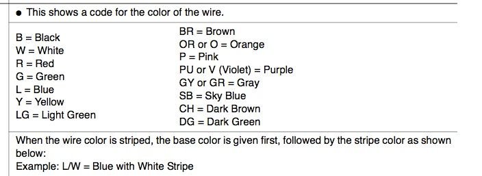

at the bottom of that window is "Click here to download a copy". That pdf is the "Power and Ground" service manual for the 2003 g35 sedan and it includes illustrations of the wiring harnesses. So based on where your mystery plugs are (??) you should be able to track down and decode what they are for. It takes some digging through these manuals, but the info is in there. Meanwhile, here are the wire color codes to help your search.

Ok, I think those are the three plugs for the early model automatic transmission before it went to a single harness.
