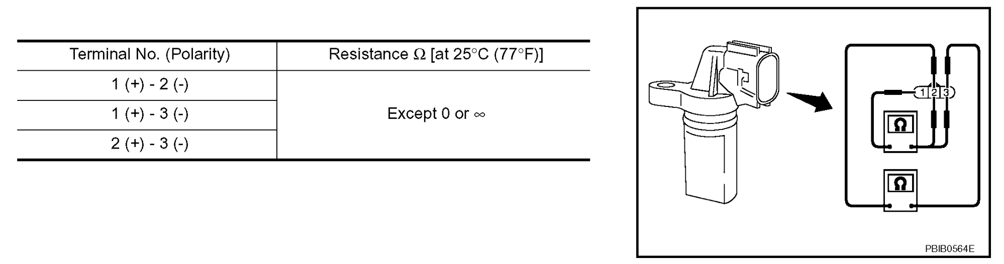

Did you do the starting fluid or carb cleaner test? Try running it with an alternate fuel source and did you check the original camshaft you took out to make sure it's actually bad? You'd need an oscilloscope to get the correct reading, but I think you can do some resistance checks on it.
