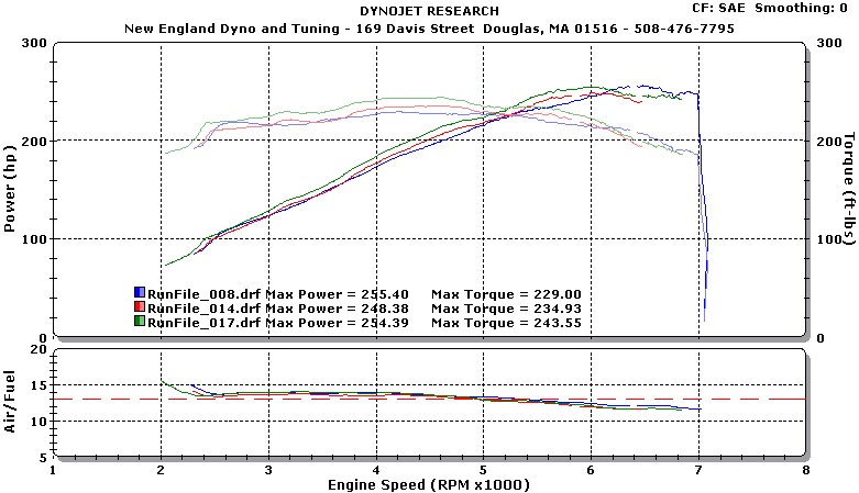

Below is three runs overlaid to show the different stages with my car. All on the same Dyno and two runs same day also.
Blue Run: Ztube, JWT Popcharger, FI cats and catback system.
Red Run: Above plus 5/16 spacer and MREV2
Green Run: Above but swapped MREV2 for my version of the MREV2
Yes I lost peak hp but I like the torque curve better. A lot of people look at hp only and that's wrong. I believe that once you open up the flow from stock, the numbers after won't match the vendors numbers. Most calculate their numbers on a "stock" car, so if you have a mod already, you're not going to get it. NO RICER MATH please. I never tried just the spacer so I can't comment on that. Wish I did but it's too late now. I'm not taking out the lower plenum now. Hope I confused you.

RebelinRI, what is your version of MREV2? you got some really good gains and recovered the lost hp.
