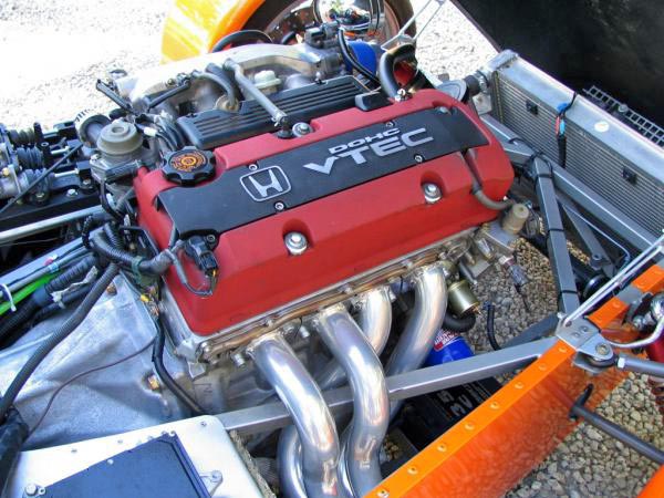

I have a 2005, first I did the intake spacer and popcharger tube & filter.... can't say about power but it did sound nice when floored. Then I put on the fast intention exhaust, now I don't hear the intake anymore but the exhaust does sound nice, if a tad loud (I plan on sound deadening my trunk and I think that will make a big difference). I'm glad I didn't go with his catalytic converters because I think it definately would of been to loud for the wife....
I think this is about as far as you can go before some serious bucks. The only thing left that I'd do is the ECU but I got a new car for going fast (240hp stock S2000motor/1200lbs) so I think I'll leave things as they are...
