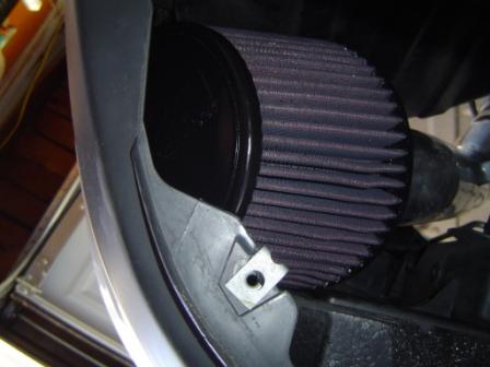

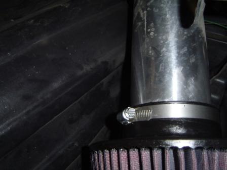

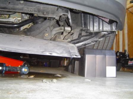

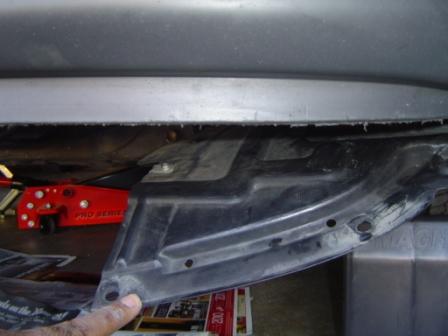

Simple way to remove your cold air intake filter..
Well Guys I did it...For those who do their own Oil(Synthetic)/Filter changes then your familar with the engine cover uinderneath that needs to be removed. Well on both sides their is a smaller piece that can be removed. Once you remove two screws pull down the cover and their it is your cold air filter waiting for you to remove and clean or replace... This was so much easier than what I was told from others like remove the bumper, turn the wheel out...NOPE THIS WAS SIMPLE TO DO!!! See Pic's
