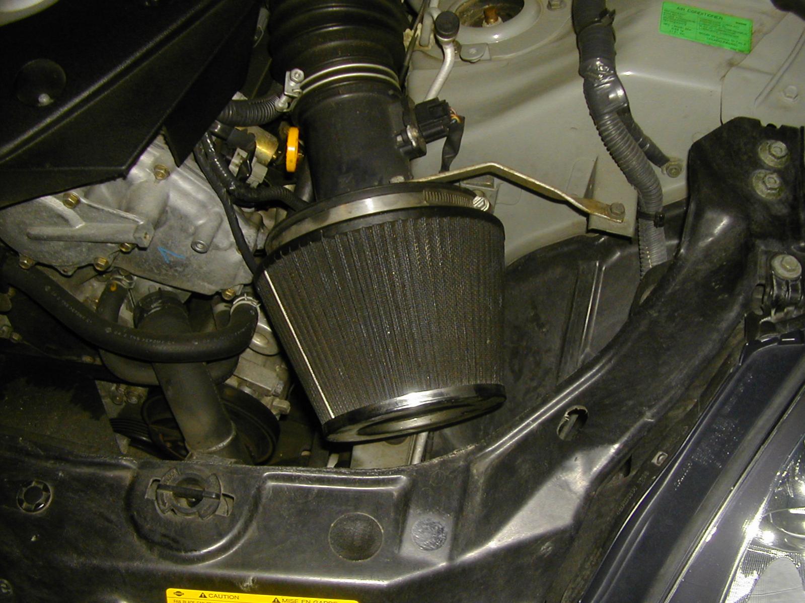

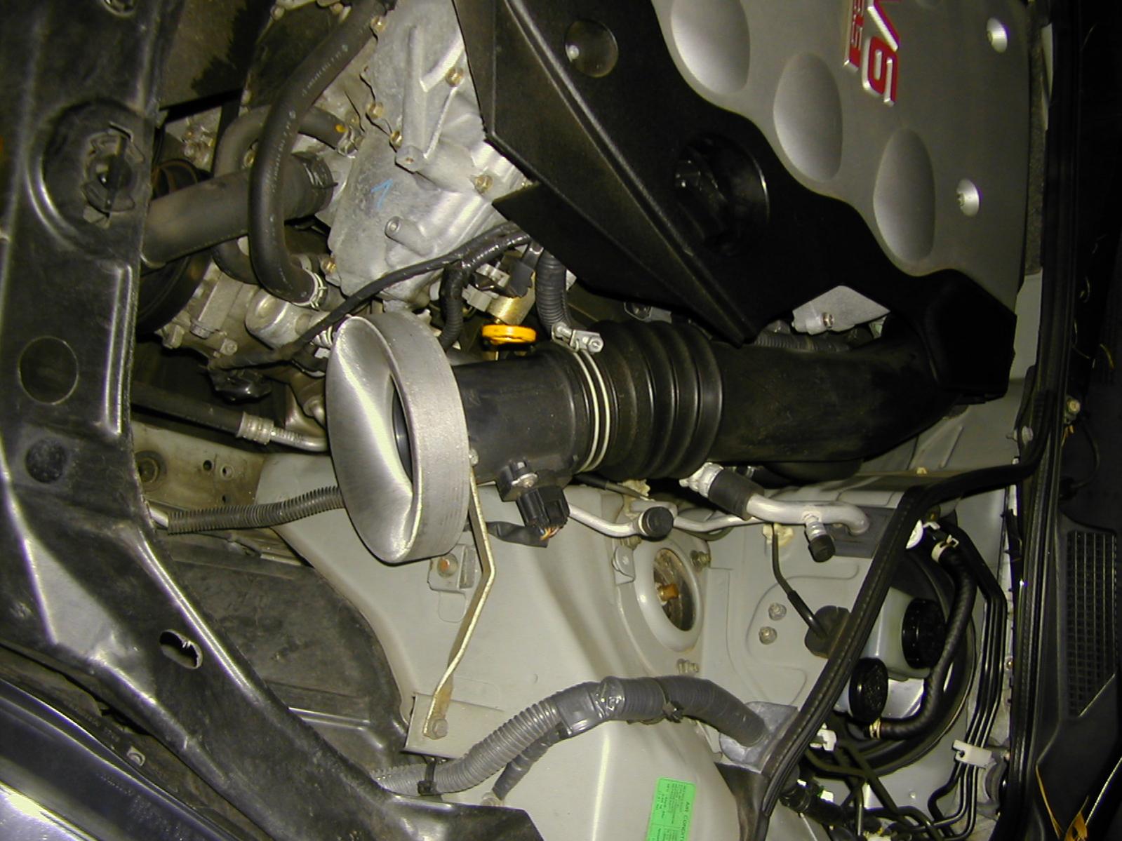

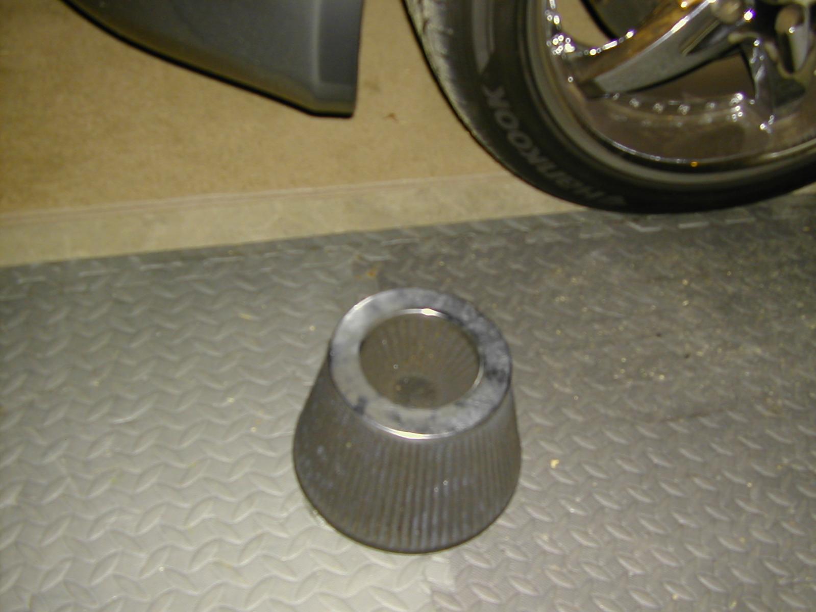

I guess I was a little vague. Here are some pics. I think it's an S&B filter because they are the only ones I've seen online with the concave top. It has a 6" inner diameter where it attaches. But..apparently you just need to clean these things and you're good to go, so I'm going to just get some cleaner and clean this beeoch.

ztube and popcharger minus the heat shield.

Okay, he posted pics, what's the answer. I have no idea, but man that is the dirtiest engine bay I've seen on a luxury car.

im sure the filters are washable. check out JWTs site to make sure. if you have an air compressor, blow the dirt/debris off from inside the filter, then rinse it from the inside out, let it dry.

Some of the K&N's used to need to be re-oiled (maybe they all do) but I don't know if this type needs oil or not. Make sure you find out.

Air compressor will damage the filter. Get a K&N filter cleaning system.
http://www.knfilters.com/clningacc.htm
1. APPLY CLEANER
Liberally spray K&N Air Filter Cleaner onto both sides of filter and allow to soak for 10 minutes to loosen the dirt. Do not allow cleaner to dry on air filter.
2. RINSE FILTER
Rinse off air filter with cool low-pressure water applied to the clean side out in order to flush the dirt out of the filter. Continue to rinse the filter until all traces of cleaner are gone. It may be necessary to repeat steps 1 and 2.
3. DRY FILTER
After rinsing, gently shake off excess water and only allow filter to dry naturally. Do not oil until the filter is completely dry.
4. OIL FILTER
A.) Squeeze Oil (99-5050)
Apply K&N Air Filter Oil evenly along the crown of each pleat. Allow oil to wick for approximately 20 minutes. Touch up any light areas on either side of filter until there is a uniform red color at all areas.
http://www.knfilters.com/images/cone-3s.jpg
B.) Aerosol Oil (99-5000)
Spray K&N Air Filter Oil evenly along the crown of each pleat holding nozzle about 3" away. Allow oil to wick for approximately 20 minutes. Touch up any light areas on either side of the filter until there is a uniform red color at all areas.
The above process is the only approved procedure for maintaining your K&N Air Filter.
