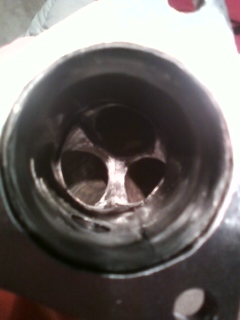

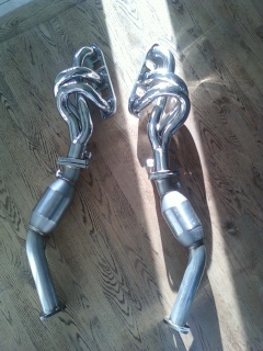

I recently ordered Top Speed headers (DC sport design) from Coz at CZP and was extremely pleased with his customer service. I am aware of the issues that happened with the fuel rails but please dont bring those up in this thread as thats not what I am discussing. Coz was extremely helpful in giving me info to get it shipped out to Canada, and I received them in 2 business days. the headers were also very well wrapped and protected. Coz is always there to answer your question, he even replied to me when I sent an email at like 2 AM I would definitely order from him again, and would recommend him.
On to the headers. I am very excited to put these on. I am going to mate them with the Fast Intentions High Flow cats that are also waiting to be installed. The header outlet matches the HFC inlet PERFECTLY (both are 6.1 cm) and Tony from Fast Intentions made the HFC outlet 2.25" to match my Borla system. I am going to get the headers ceramic coated, and then the components will be installed by SG Motorsport this summer. They will also be replacing the Borla H pipe with a Magnaflow X pipe in the process. Then it will be time for an Osiris Dynotune!
Attached Thumbnails Top speed headers from Concept Z Performance-1103221755000.jpg   Top speed headers from Concept Z Performance-1103222221001.jpg   Top speed headers from Concept Z Performance-1103222223000.jpg   Top speed headers from Concept Z Performance-1103222221000.jpg   Top speed headers from Concept Z Performance-1103222223001.jpg

I am expecting good gains. People say that headers dont give power, but I think when they are paired with the HFCs they will.

they wont, not until cams will headers really make any difference other than sound.
the top end will drag out a bit more but peak should be around the same. Revups like headers more than non-revs because they run slightly more aggressive stock cams and they have exhaust cam phasing.

Oh well....as soon as I finish this off Im going to start saving to pull out the engine and get it built and boosted so I guess these are just for sound for me
The main reason I decided to get them is that I was getting a tune with or without them this summer, and I didnt want to have to pay to tune it twice if I ended up buying headers down the road
From "good gains" I didnt just mean the headers specifically I imagine they would give me around 7 whp average (http://www.turbomagazine.com/tech/04...ers/index.html)
I meant the addition of all of these with a tune would hopefully net me around 15-20 whp since the cats are a huge choking point.
