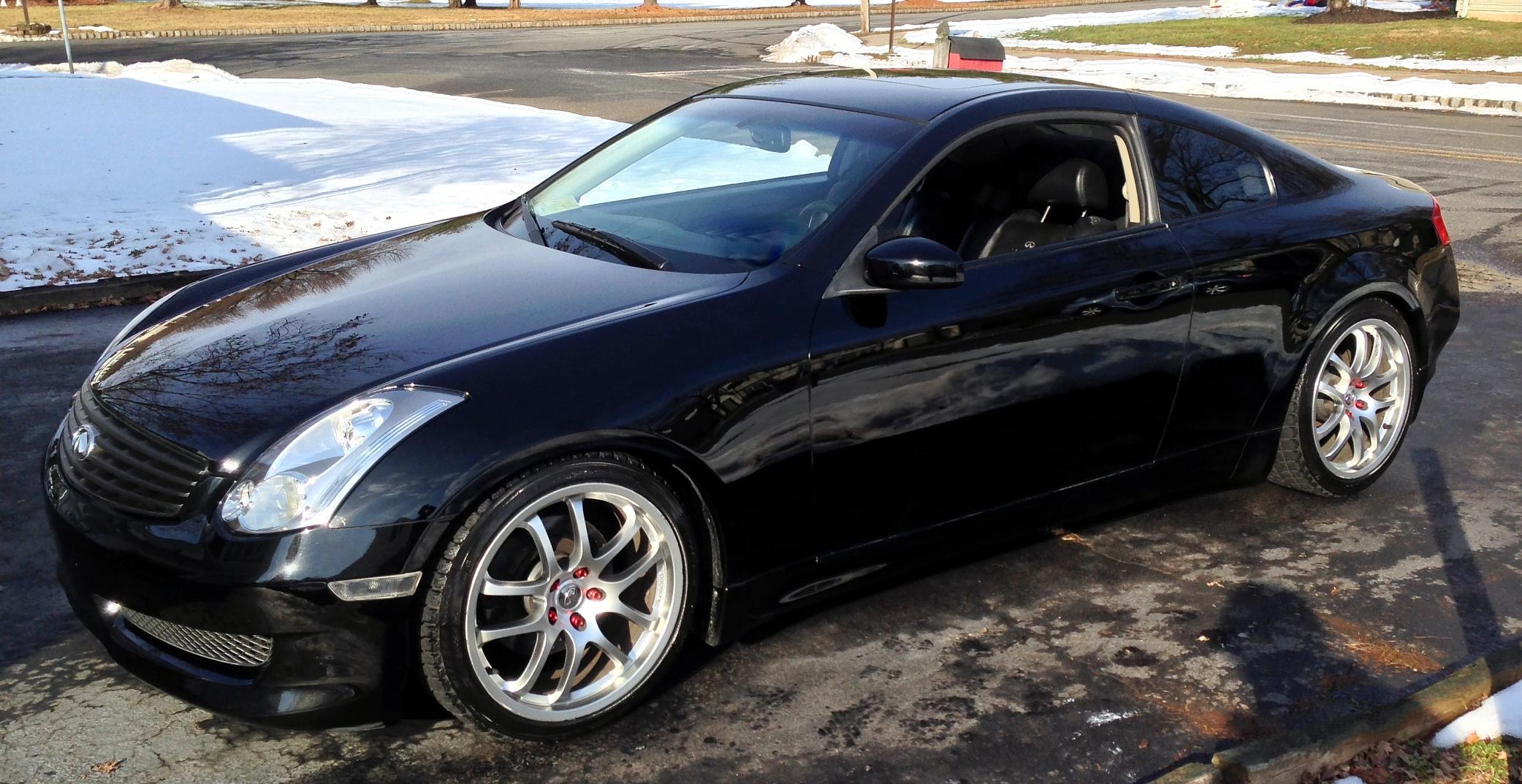

Here's the car that the mods are going on.

Love Seein a clean coupe dropped with OEM rays.
Looks good
What lugs are you using?

Thanks for the compliment! The lug nuts are BWR.

Beautiful OB coupe, although red lugs wouldn't be my choice! You'll love the results of the Osiris tune, that is the best bang for your $$! Hang on to the Berk's, if you're anything like me I love driving with the windows down...you're not going to like the exhaust smell. I only had my ART pipes on for a week, that was long enough.
