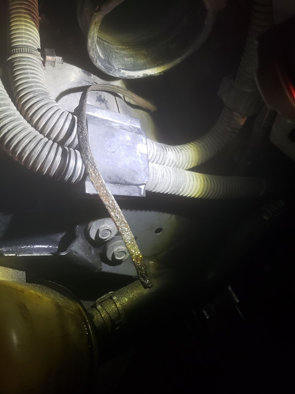

Old Mar 6, 2022 | 11:55 AM
MandMmom6609's Avatar
Joined: Mar 2022
Posts: 2
From: Round Rock
G-35x
Old Mar 6, 2022 | 12:22 PM
cleric670's Avatar
BANNED!!!
Joined: May 2017
Posts: 14,837
Likes: 2,497
From: Washington State
Coupe 6MT Premium RAS
Ok so typically those braided ground straps went to exhaust components, it might have been originally landed on the headers.
The blackened end on it looks like it got into something energized, maybe on the alternator, and arced out.
I would just fold it up and cable tie it out of the way to make sure it doesn't end up on the alternator again and fry something.
Then verify your ground path from the engine all the way to the negative on the battery. Not sure about the V36 chassis but the V35 has a main bonding jumper from the right (passenger) side of the timing chain cover that goes to the chassis below the coolant reservoir.
Also make sure both ends of your negative battery cable are brushed down to clean bare metal, apply a little electrical anti-oxidation grease to all mated fittings before reinstalling.
