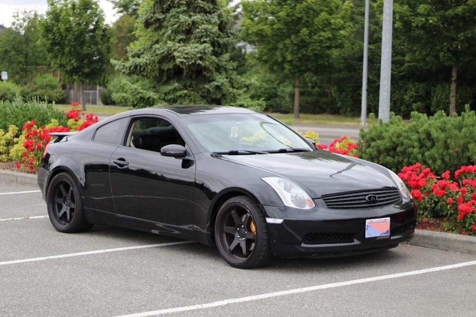

Hey guys, I'm pretty inexperienced when it comes to cars as my 04' G35 is my first car I got about two months ago.
So, I went and got my oil/filter done, and I knew I had an exhaust leak to begin with, but was told that it was coming from my headers due to them being cracked. I was told I had the option to get it welded, but I'm pretty sure that's a temporary fix.
Anyways I guess I need to replace them, just curious to see what you all would suggest I buy. I don't have a huge budget to work with, I'd like to try and keep the entire thing (including labor) as close to $1,000 CAD as I can. I have Z1 test pipes, which is the only exhaust mod I've got, pretty certain my headers are stock but I don't think I want to go back to stock unless that would be the best idea.
Thanks in advance, apologize for being such a noob to all of this. Really trying to learn as much as I can lol
