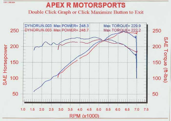

Originally Posted by sen_jen
anywhere from 4whp - 12whp max. as far as torque figures, they range from +/- x - xx whp. you sacrifice low end, or you gain low end, and equal out the hp mid-top end.
WRONG!
First off my car is a 2003 "G" 6MT Coupe.
Mods:
TechnoSquare Crawford Reflash ECU
JWT PopCharger with "Z" Tube
Crawford V4 Plenum
Crawford HiFlow Cats
Crawford Headers (Aint that what this thread is about?)
Invidia G200 Dual Exhaust with "H" Pipe
Ground Wires
I ran my lightly modded coupe against a 2005 "G" Coupe 6MT on a DynoJet. So here's a guy with the new 298HP engine with the new cams, exhaust timing and bottom plenum. His only mods are a K&N Filter, "Z" Tube, and Ground Wires.
It was a warm night here in Tucson, about 94F, so horsepower levels are probably a bit low. Anyway '05 went on the Dyno for three runs, and he has a range of from 236 to 242 horspower. We then do a switch and add the Motordyne 3/8" Plenum Spacer. This is the first one I've seen, and it is a real stealth mod. We want to see if it works. Does three more pulls and he gets 248 horspower for each of his runs. So yes, to put all rumors aside. I saw exactly what he did. Six runs back to back. Plenums do work on the new engine.
Now for the exciting stuff, for me! The techs are just buttoning up my up may car, and we all want to see how the old modded engine, does against his new 2005 engine. So I start up my car, sounds great BTW, and drive it on to the Dyno. The modded ECU is reset, because the battery has been disconnected for and day and a half, so it has not relearned my aggressive driving habits. He drives my car on the Dyno, 3 pulls. Results all exactly the same. HP and Torque are corrected SAE. I've attached the results My Lines are Blue, his (the 2005 with the Motordyne) is Red. We peak about the same 248HP, but I peak 7-1/2 pound feet of torque higher then him. And if you look and the curves, I beat him in all the power ranges up to about 6300 RPM, where the new plenum runners and cam take me by about 1/2HP. I was hoping for a run of 250, but what the heck. See Graph attached.
My ride home was great. Those headers, are the most significant mod I've done. I can really feel the kick in the butt. I should have done this long ago.
Lou

Lowrider, do you think you would get significant gains in the '05 as well with new headers?
From all that I've heard the RevUp engine is very responsive to Bolt On Mods. So, IMO, the answer would be a definite YES! Since the RevUp, breaths better anyway, thanks to the new exhaust cams, headers should do more for the new motor, than they did for me. However, get the BEST, get CRAWFORD. And - Don't forget the Hi-Flow Cats.
