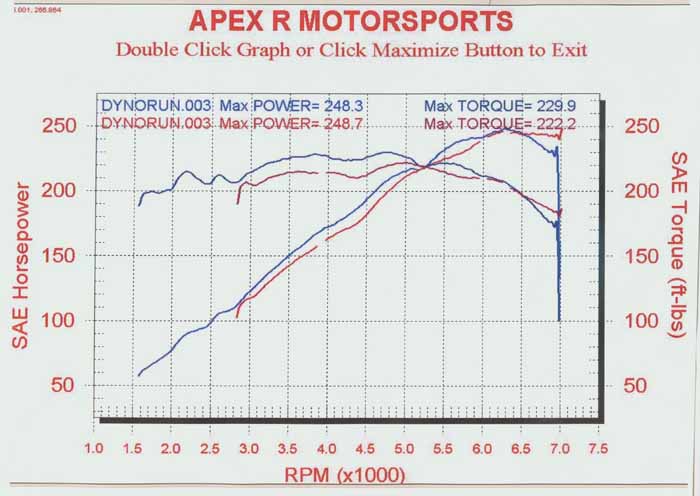

I've posted my Dyno on this forum. I have an '03 6MT with the full Crawford Package, JWT PopCharger, and Invidia G200 Exhaust. The Headers gave me the biggest kick in the paints, followed by the Plenum. In my book the Crawford Headers are worth every penny. As a point of reference, my car is the Blue Line, the Red Line is an '05 6MT with the RevUp Engine and a 5/16" Plenum Spacer.

Yeah, I've seen your dyno before. Sorry for my ignorance, but one question I do have is; what does the 05 have besides 5/16" spacer?

Nothing! But, as I said, it's the RevUp Motor. Oh, I forgot to mention I also have the Technosquare Crawford Flash on my ECU. That's the reason I can rev above redline, where my power starts to fall off, but the RevUp starts to make more power than me.

What was your baseline dyno. According to my figures, you should have dynoed somewhere near 224rwhp bone stock. If this is correct then you had a gain of 24rwhp from all those mods, which is good no doubt. But, if Alphawerks give 17rwhp alone then I pick them or CrawfordZ. Please understand, that I'm not trying to down your mods in anyway shape or form. I'm just telling you what I see from the numbers alone. Anyway, just my 2 cents; thanks for listening.

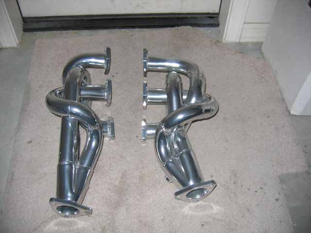

I don't have a baseline Dyno, but 222 to 224 sounds about right. Where have you seen an independent dyno with ONLY alphawerks headers that showed a 17HP gain? No header will do that. BTW, the stock header is really not that bad, but the Crawfords are a work of art. A true collector, not just a larger pipe shoved on the end as a merge. And, all the pipes are equal length, about 22". No other header comes close to that. Oh, and no offense taken, but we are talking real numbers here.

Click on the link below. Coupeondubs pulled average whp gain of 17.64 whp and an average tq gain of 16.40 lbs/tq. This was is average of all 3 pulls. Now is baseline is a bit low, which is do to the dyno fans being turned off and his heavy *** 20's. By the way the CrawfordZ are sweet looking. Nice pic.

I'm not going to argue with you guys, buy what you want. The Alphawerks don't look equal length to me, but if they are the runners certainly aren't 22" like the Crawfords. As far as the Dyno goes, Bottom line, that "G" put out 234+ HP mine put out 248+. That's 14HP in my book.
As far as the quality of the header for gosh sakes look at the collector and the bends of the runners. You get what you pay for, if you want an inexpensive header, fine. But, if it were me I'd go with the DC or Strup, same design, less $.
