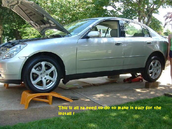

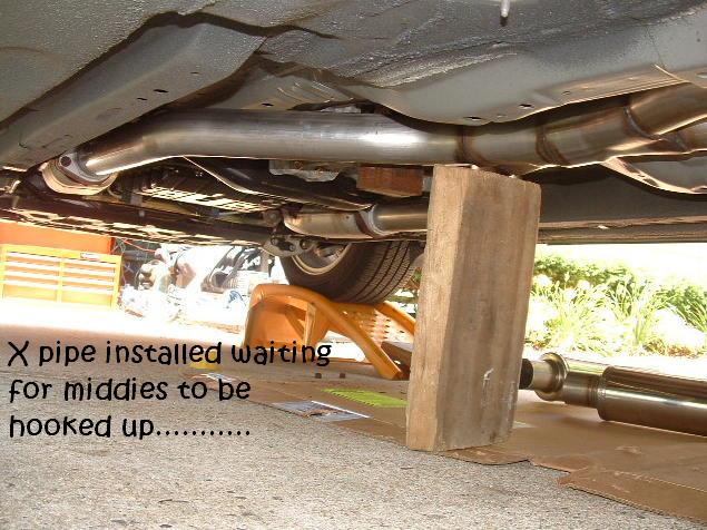

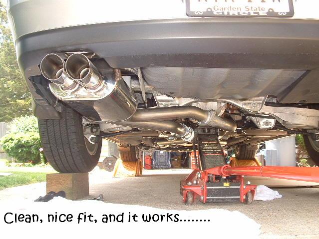

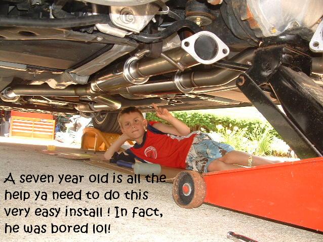

I thought you checked out my pictorial on the DIY https://g35driver.com/forums/showthr...t-back+install. Cast your beady lil' eyes below Note the small extensions at the base of the front ramps to prevent the front spoiler lip from touching. If you're flying solo.....have a few different lengths of wood avail. to block the exhaust sections as you go along. Only finger snug bolts as you go along until the final alignment is right and where you want it. jbx

Of course I did! I was just trying to figure out how to use my jackstands since I already have them (things like this were much easier on my F-150). From what I have seen, the proper placement for the jackstands is under the side sills but I am just not comfortable with this because it seems like the top of the jackstands would damage/bend something.
G35_TX had a good suggestion to place them under the spring sets. I will either try that or buy a second set of ramps and place them under the rear wheels like you did with the wood blocks.

By the way, the jack stands under the rear spring sets worked perfectly, thanks again for the help!
