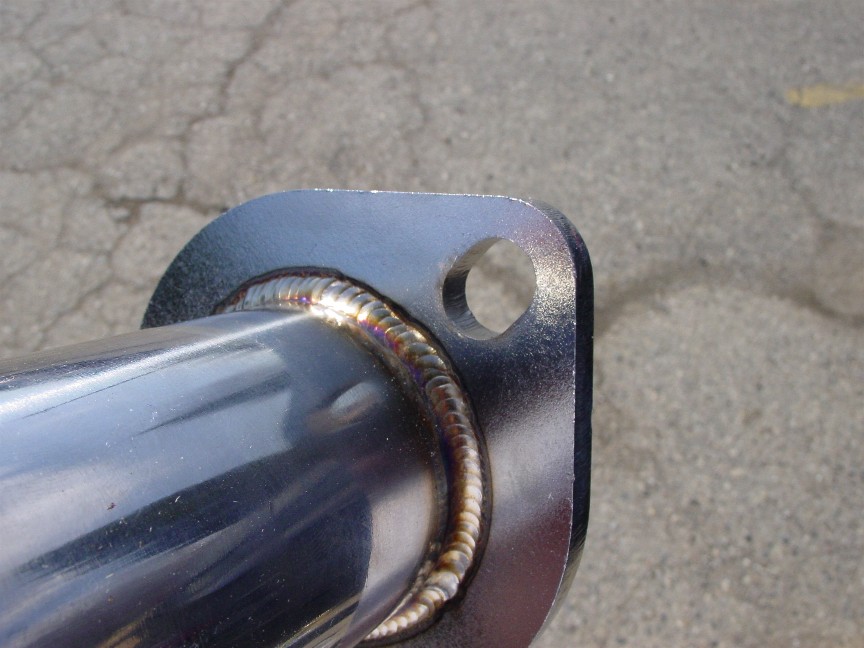

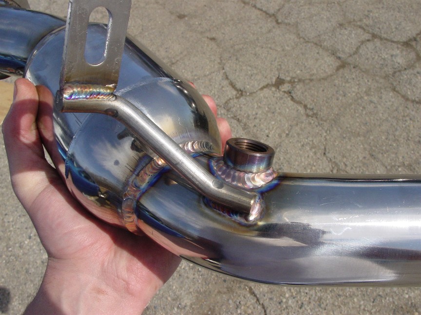

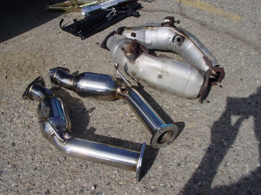

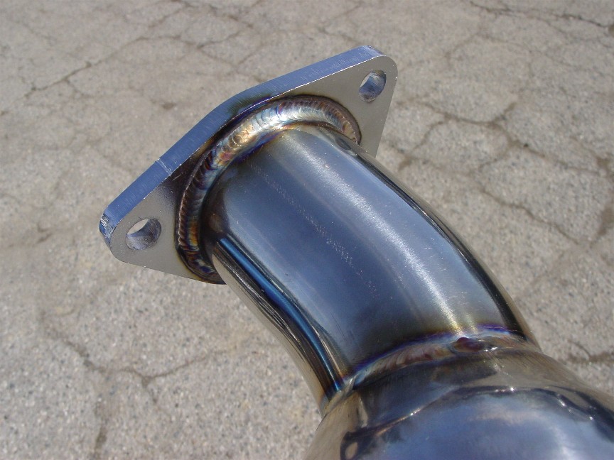

This past weekend I was able to install my new UTR resonated test pipes. I promised I would write a review and post some sound clips on this site. I dont have any sound clips yet but I do have pictures (see attachments)
The installation was actually quite easy. I had about 30" worth of extensions on a 1/2" drive ratchet with a breaker bar, so I had no problem breaking all of the nuts loose from the engine bay or under the car. I did the install at my fraternity house, so it took a while to find a couple little things...like a jack. If I had done the install at home I could have easily done it in under 2 hours.
Anyway, the pipes fit very well, the support brackets lined up well enough to get the bolts through without a problem. The only thing I noticed was that they may be a little short...in other words, I had to pull the Y pipe forward about 1/4" - 3/8" to get the pipes to mate up. Besides that, they fit well and nothing rubs or anything.
I have them installed on a bone stock 03' with only a Z-tube. At first I had just the pipes on, and then I added the Z tube a few days later, but I could barely tell the difference with and without the Z tube (The z tube is only noticeable at higher rpms).
All in all the car is still "quiet" by my stadards...its just a little louder than stock. Basically imagine the stock exhaust note, only aplified slightly. When driving in the car, it sounds very good, and no rasp can be heard whatsoever.
However, last night I switched cars with my friend so I could hear the exhaust from outside while driving. From outside/behind the car there is a little bit of a raspy civic sound, although it is not very pronounced. I was really quite suprised when I heard it, because there is not even a hint of that sound inside the car .
