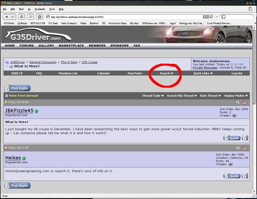

I just bought my 06 coupe in December. I have been researching the best ways to gain more power w/out forced induction. MREV keeps coming up - can someone please tell me what it is and how it works?
