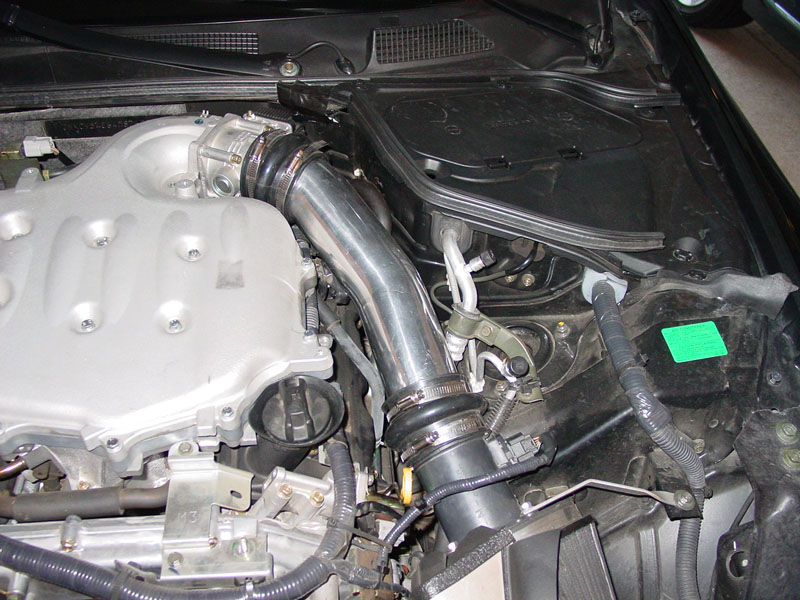

Here's a picture of the setup/install. Anyone see anything wrong?

There is a huge bend in your tube noob
I think it's backwards...
The shorter end goes up near the plenum, and the longer end goes towards the ram air box...
Look at pix...
http://www.unlimitedtuning.com/perfUTR1.htm
Your ztube doesn't have any bends? Noob? Please.
Look at pix...
I've tried both ways.. No luck. Notice how the 2nd bend on my ztube is about 2/3 of the way down the tube while the one pictured on the UTR website is about 1/2 down..
Im emailing the vender the pictures now as we speak.
Thanks,
Jeff

Okay. Maybe I do have the tube on backwards, but we'll see.
