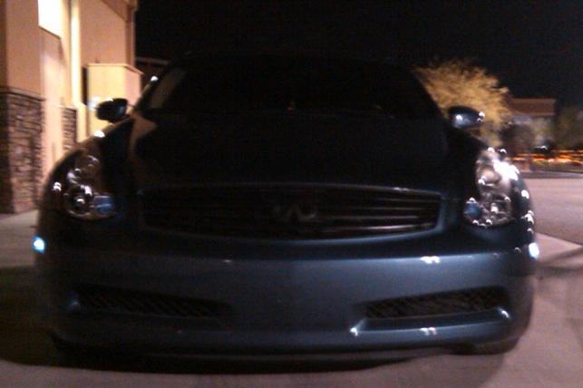

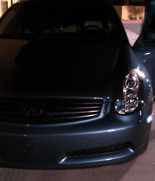

Originally Posted by vrezhg
how u guys think a caribbean blue g would look wit a gloss black grill wit the emblem chrome?
I know the CB is lighter but just to give you a rough idea
