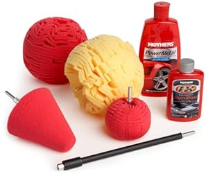

I had to polish insides of someones headlights once that had bad condensation. Easiest way is with mothers powerball and cone with some Mezerna cutting polish. Took me about 15 minutes per lens. Then wetsand and polish outside.
