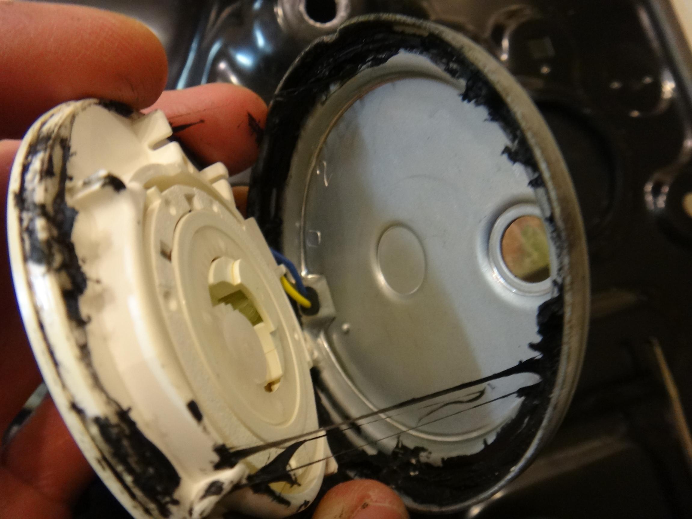

I don't understand this... hopefully someone can help me out. I was having a problem with my window motor. Occasionally it wouldn't respond and I'd have to hit the switch a couple times. Finally, it died. I took it apart and realized the motor brushes were worn down, so I replaced those. Good as new. BUT, when I went to reset the motor, nothing worked. Out of curiosity I took the rubber button off to make sure everything was aligned, and noticed there was nothing under it but plastic. I figured it was misaligned, so I pulled the lid off to see what was going on and that's where I'm completely stuck. It looks like everything is aligned the way it should be, but there is nothing for the rubber reset button to press against. I'm totally confused... it did work before the brush repair. Is there a piece that somehow went missing? I've looked all over the internet to try to get an idea what these things look like when pulled apart, and can't find anything. If someone has a spare one that died and you can pry the lid off and send me a photo of, I'd really appreciate it!! I can't spend $200 to $300 for a new motor just because the stupid reset switch. At the same time, it is so annoying having the window drop an inch every time I open the door and not roll back up when I close the door.

it was never literally a button. that disc spins and when u press the rubber "button" it stops the disc from spinning. somewhere in that process that's how the motor sets itself
All this technology and someone went putting some Flinstones style invention in the car?! Well thanks for the explanation... I thought I was going crazy. Looks like the problem resetting is a straight up malfunction of the motor then... too bad.
