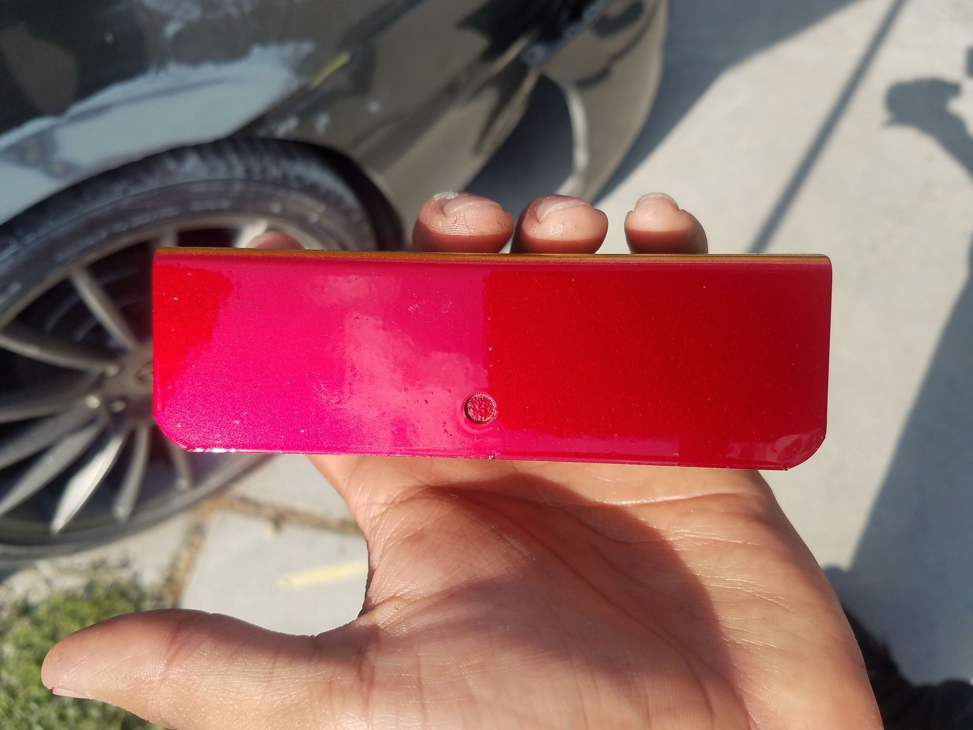

I think I need more coats of candy I only did 4 coats on all samples

I know that's a test piece, but I hope your spraying environment is cleaner than that. might be a bit heavy on the coats, I see sagging and orange peel.

The Orange peek is heavy I sprayed some primer to thick and didn't bother to sand it flat and just started spraying I just wanted to see the color I HATE orange peel

The brandy over galaxy grey looks good there. I think I prefer it over gold though, like the gamma gold you have just with another coat of brandywine. Most people go with 4 coats but like you say, I think one more would deepen/darken the red just about right.
I'm interested to see it over the metallic black. Most I've seen over black comes out cherry/slightly purple but I wonder if a 5th coat of brandy will make it more red/less purple. So far I'm thinking more towards a metallic gold. I could use the same gold on my wheels too...

Are you going to spray 2k primer?
I think I should of done more coats of brandy on the gamma gold
I just need need to buy some black with heavy metallic or up try to mix some galaxy grey with solid black base
And yeah mines came out some what purple
I sprayed it brandy over black

Yeah I'm using 2k primer surfacer. I was going to go over the entire car with 2-3 coats but I've been recommended to just prime the parts I've done work on/bondo/filler. That would save a good chunk of time and primer. What would you recommend?
The paint shop told me black with heavy metallic will come out dark grey, sort of charcoal colour.
I know for sure the black would be too dark/purple. The silvers seem to bright but galaxy grey could be what I'm looking for, maybe with 5 coats of brandy. Or 5 over gold.

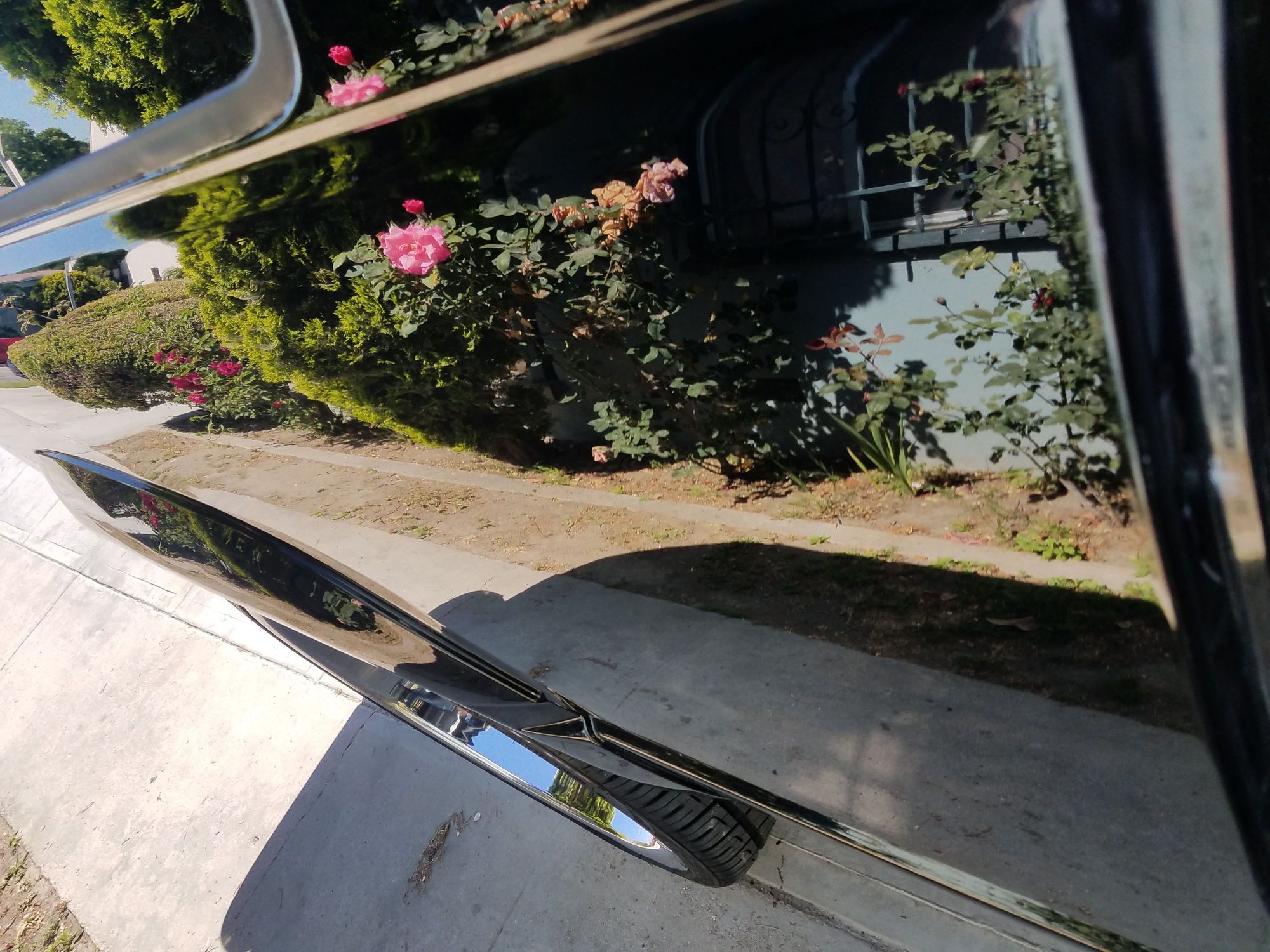

That's my black tahoe no orange peel
