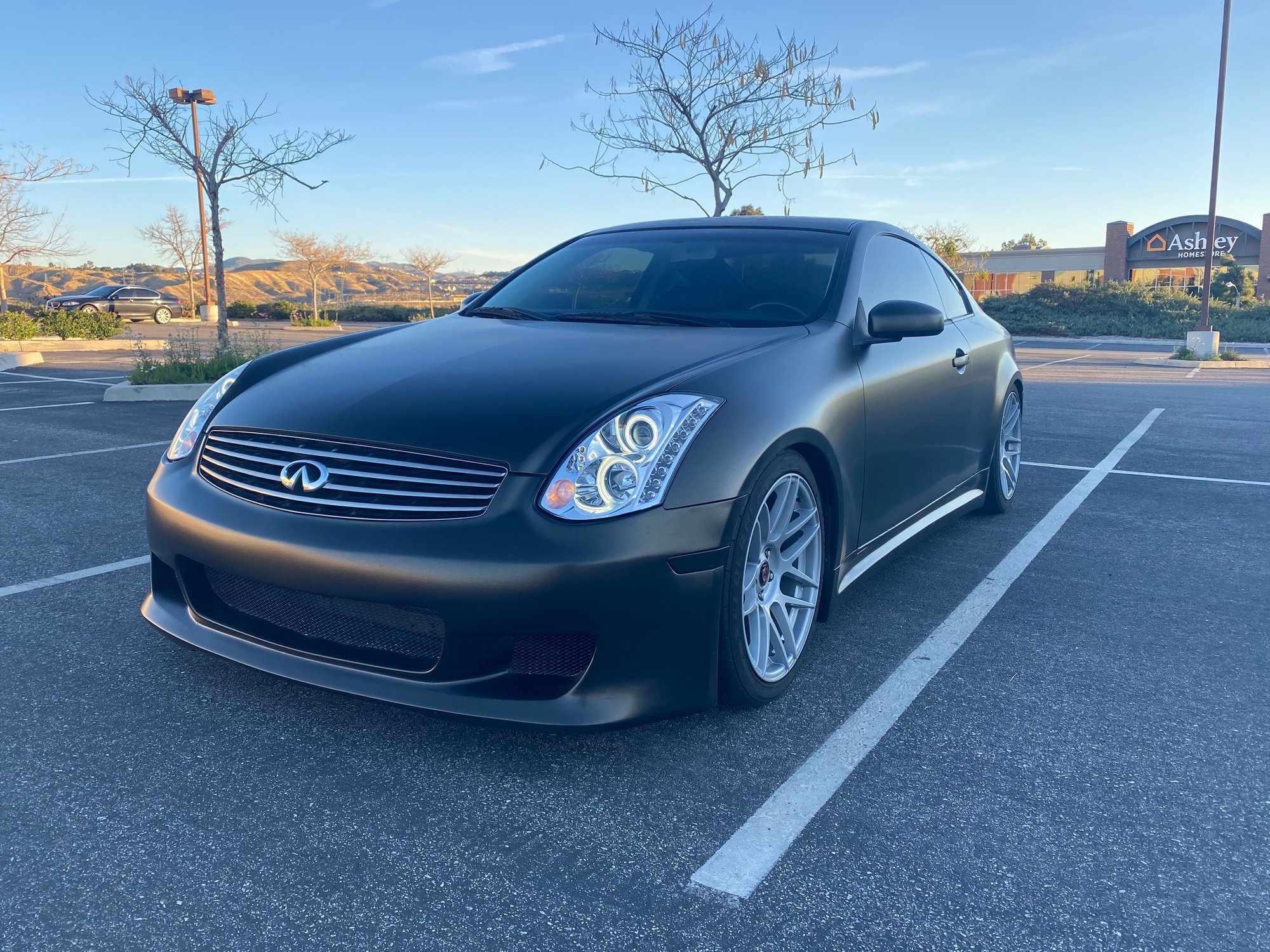

Originally Posted by jbarnett250
Have you wrapped a whole car? I wrapped a couple pieces of interior trim and I found it pretty difficult to look REALLY good. There's always something bunching up or stretching around complex curves.
Yeah my whole car is wrapped. The big flat panels are easy to do. But when u get to the edges it becomes difficult. My front bumper was the worst. I tried to wrap it in one whole piece but realized its just not gonna happen. I had to do inlays.
It looks real nice at first, but then u start getting little bubbles here and there. And its only been about 2 years since I wrapped it and the whole thing is already discolored in different areas, and some parts have dried up and cracked.
Its just not worth it to me…I wouldnt do it again to a daily driver.
Old Nov 5, 2022 | 12:19 AM
jbarnett250's Avatar
Joined: Sep 2014
Posts: 377
Likes: 55
From: Walpole MA
Big respect for pulling that off. Looks great from that far away. I was thinking the bumper would be tough. The double din and shifter trim is hard because it's more holes and curves than flat surface. But getting all the edges of even the flat panels to stick permanently isn't trivial on your first try. I was going to recommend to the OP to just get enough to do the bumper or maybe the hood or trunk lid to see if they can do it and be happy with the results before spending the money for the full car. It's cheaper than paint but still not "cheap" if you end up throwing it away because it's too hard to do.
