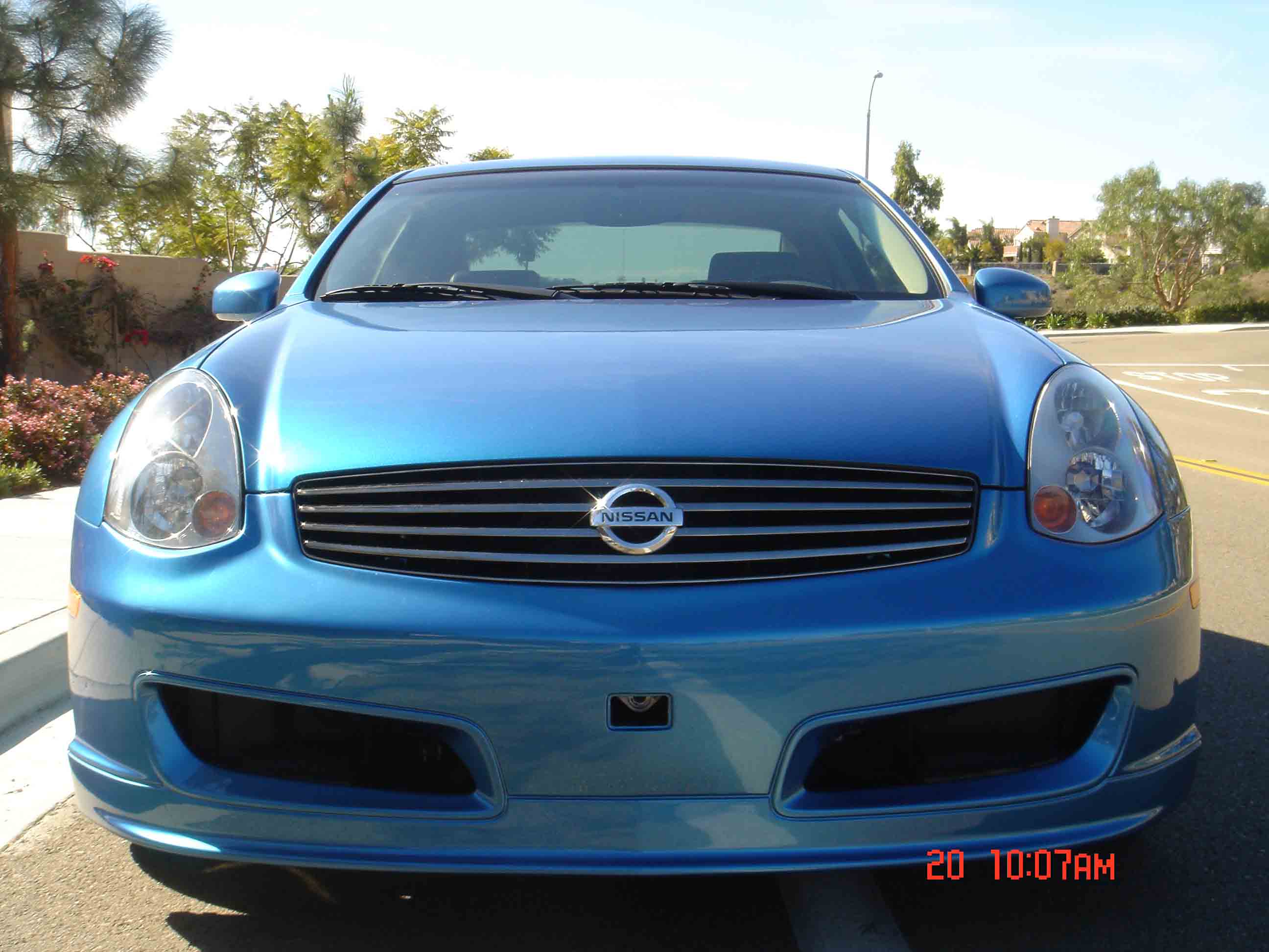

Hello i'am new to this forum but been reading for info here a while i just install a Nismo front bumper on my car 1 the Center cap for the plate does not fit
anyone that has install one can tell me what u did and also where or what did u use for eye lids grills?

do you mean the center cap that covers the tow hook access on your oem bumper? I think you should of told the bodyshop to modify the tow hook access on the nismo front so that you could fit the oem cap on.

Yes its the center cap for the toe hitch just that Nismo didnot provide me with one and i took the ones off my original bumper i should of taken it off then got it painted same time but (
i like if anyone that has a Nismo Front Bumper tell me or show me what they did .

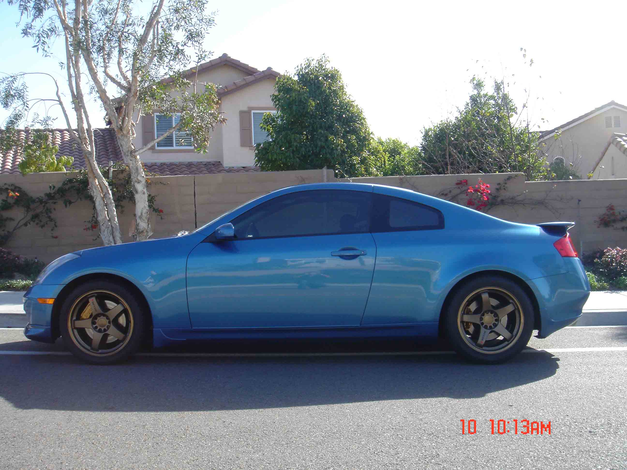

and the only thing i've done so far is just the bumper i'am currently looking for other nismo peices, also i got Nismo 18" Bronze Wheels Engine wise just a Z tube and K& N Filter .
Attached Thumbnails Nismo front Bumper Help!-back1.jpg   Nismo front Bumper Help!-side1.jpg   Nismo front Bumper Help!-side2.jpg

either you fill it in or you modify it so the cap fits in. your bodyshop can do that

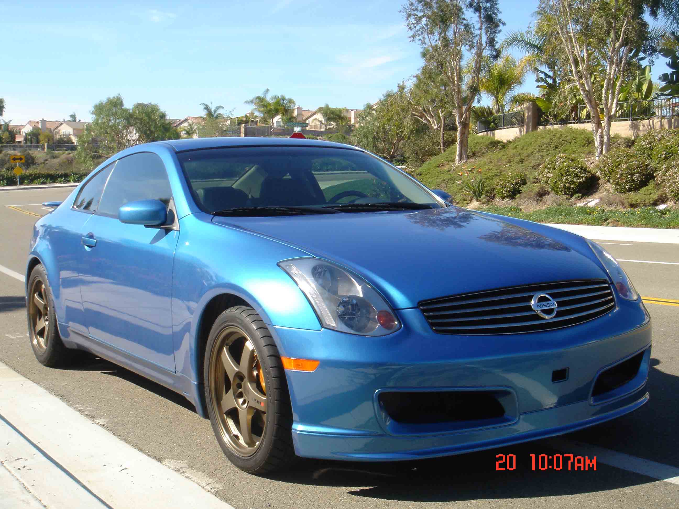

here is my type N front!
i asked the body shop to fill the hole for me!

supsup...do you have any more closer side shots to show how the front matches with stock sides?

Is your bumper the authentic one or the replica? I have the authentic one and the tow hook square from the oem bumper fit. However, I had it filled in regardless.

Its Oem Nismo the problem is i got the bumper painted first so the thickness of the pain i think just made it enough not to fit it almost goes in i will have to shave some of the fiber glass

I wouldn't shave the bumper. I'd shave the tow hook square. Or try a heat gun on the square, then try to force it into the hole while it's still pliable. Have your body shop try the heat gun method so you don't end up damaging the bumper.

is that towhook really neccessary? i mean what happens if you fill it in and your car dies and needs to be tolled? then your screwed?
