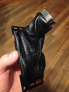

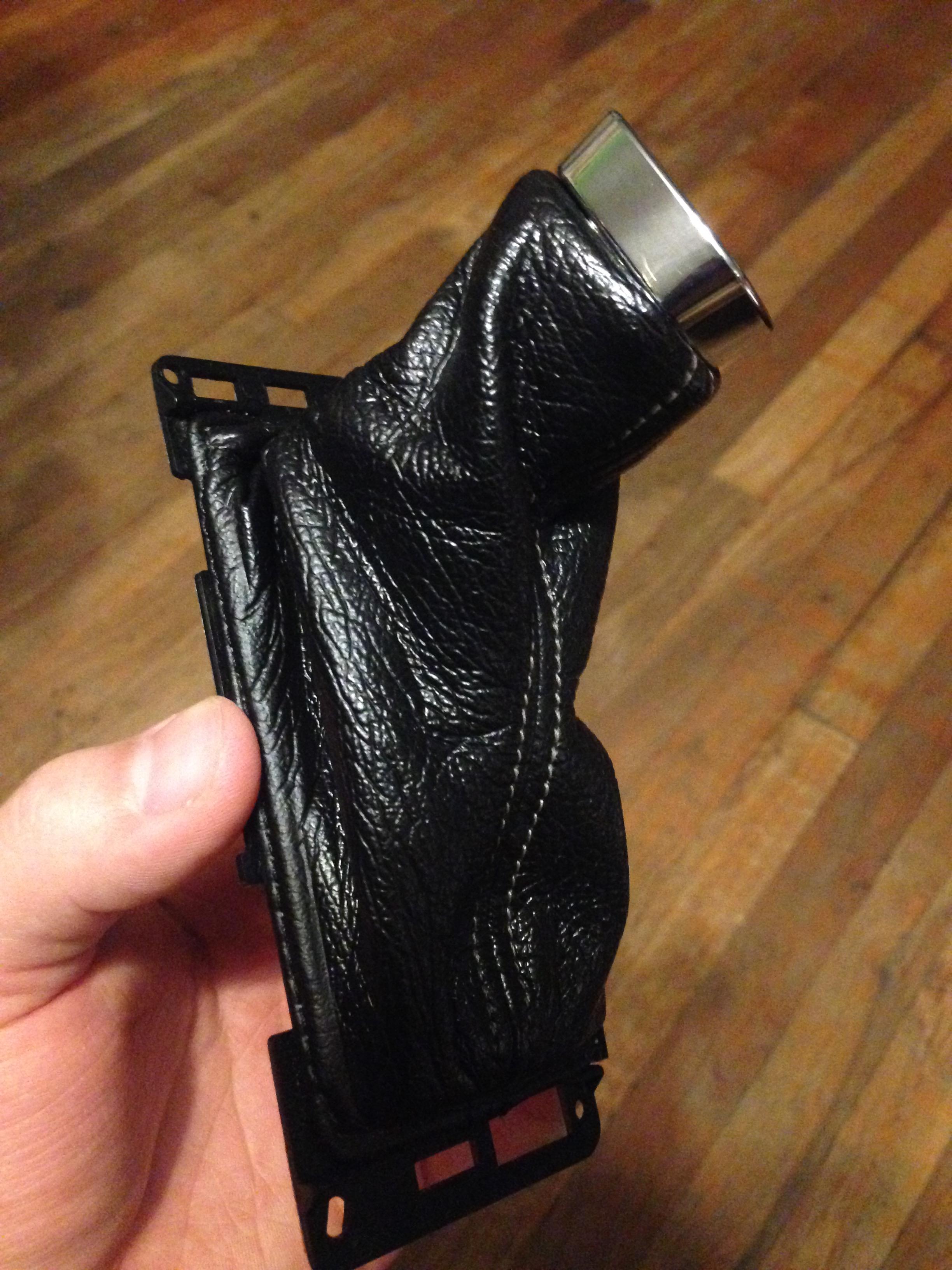

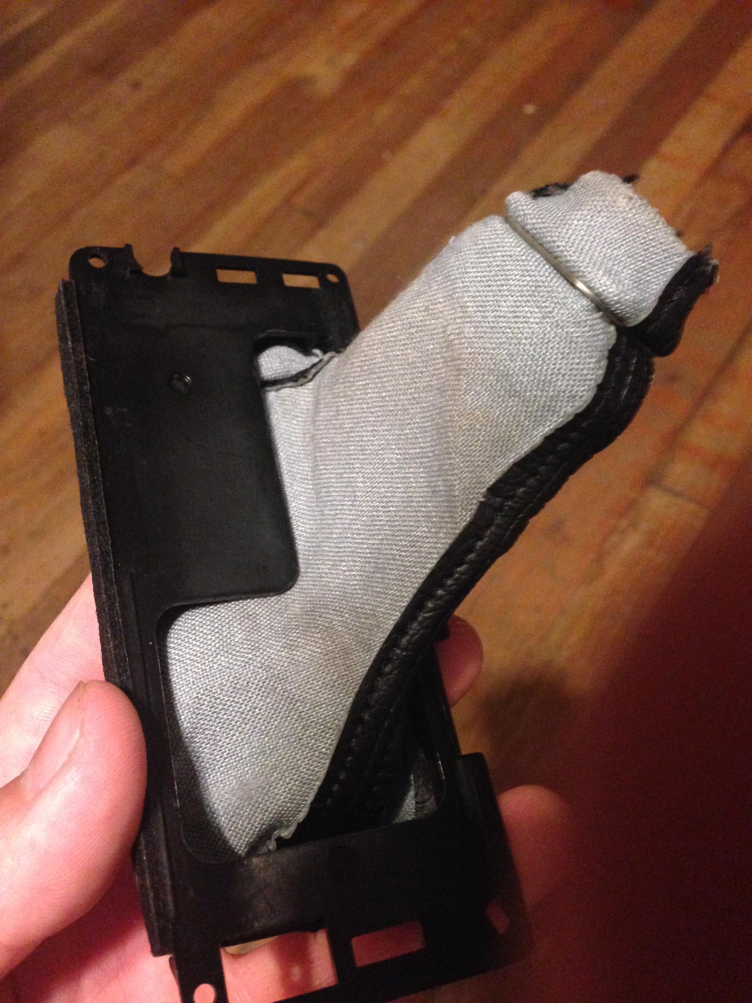

Were you successful in getting the Momo on your 06? I am having having difficulties taking off that connector piece. Can you give a brief description on how to remove the connector piece?
Thanks
To take the chrome piece off the AT shift boot you'll have to remove the shifter console, then turn the boot inside out and remove that clip you see pictured.

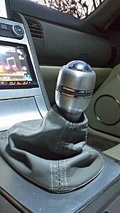

Originally Posted by corvette933
Hi, I have a 2006 infiniti g35 coupe. I want to replace the old automatic shift **** with a new one. What I'm planning on doing is getting an 8 ball. The problem is, the locking button on the shift ****. So my idea was to cut a hole into the ball and put a button in there. Have y'all ever seen anything like this or any suggestions would be appreciated. Thank you.
Why go thru all that trouble when I have a Momo Auto Shift **** for sale that'll work perfectly!
