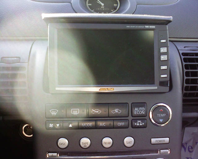

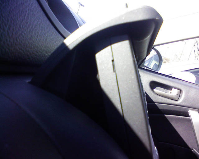

It actaully is NOT that hard or complicated. And i can swear the cubby is attached. I mounted my monitor where the stock monitor goes.
There are directions floating on the forum and the web about the removal. I'd say it's a 1hr job if everything goes as planned.
Looking at the pictures obviously i have wires running behind the unit
