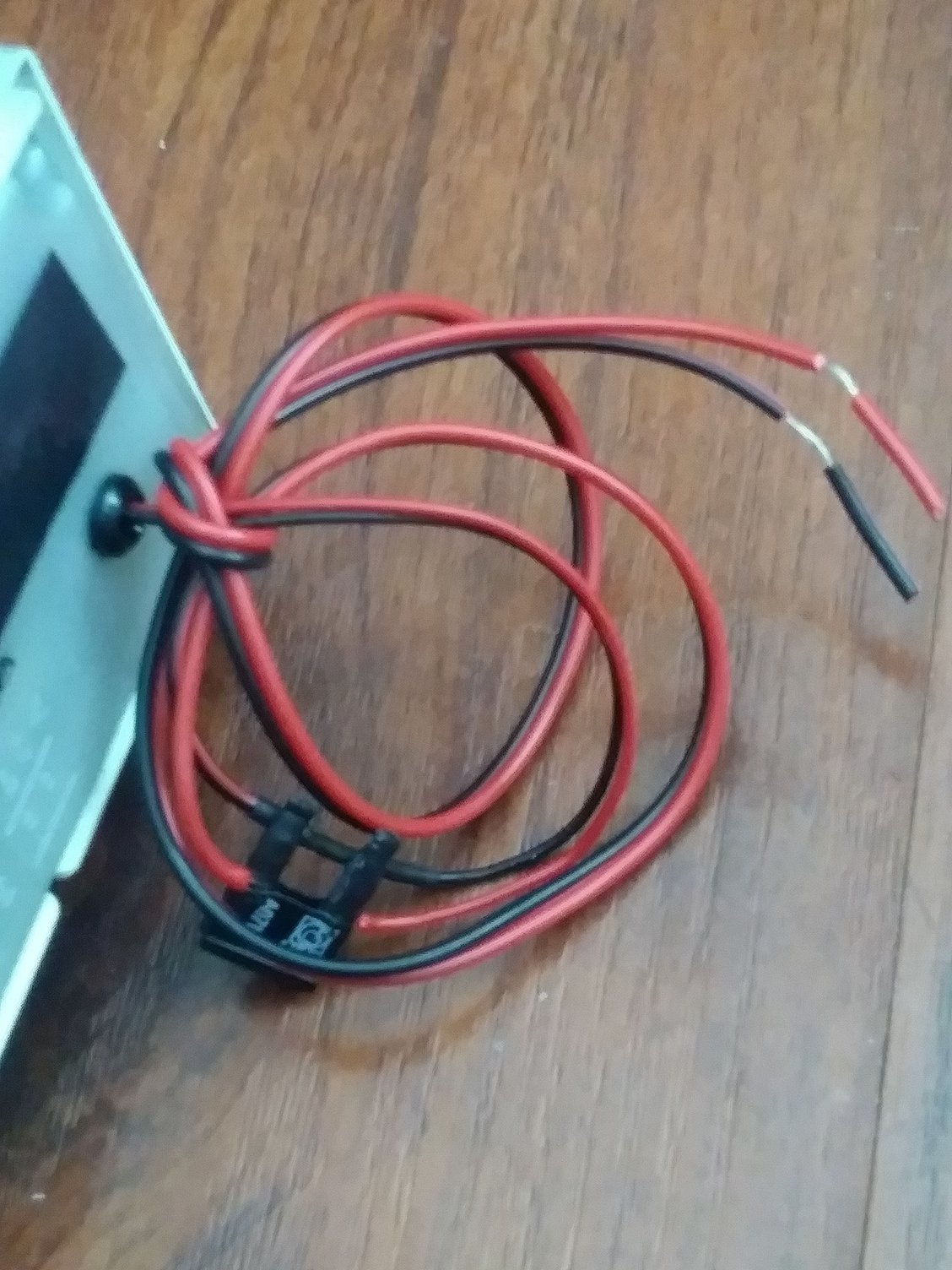

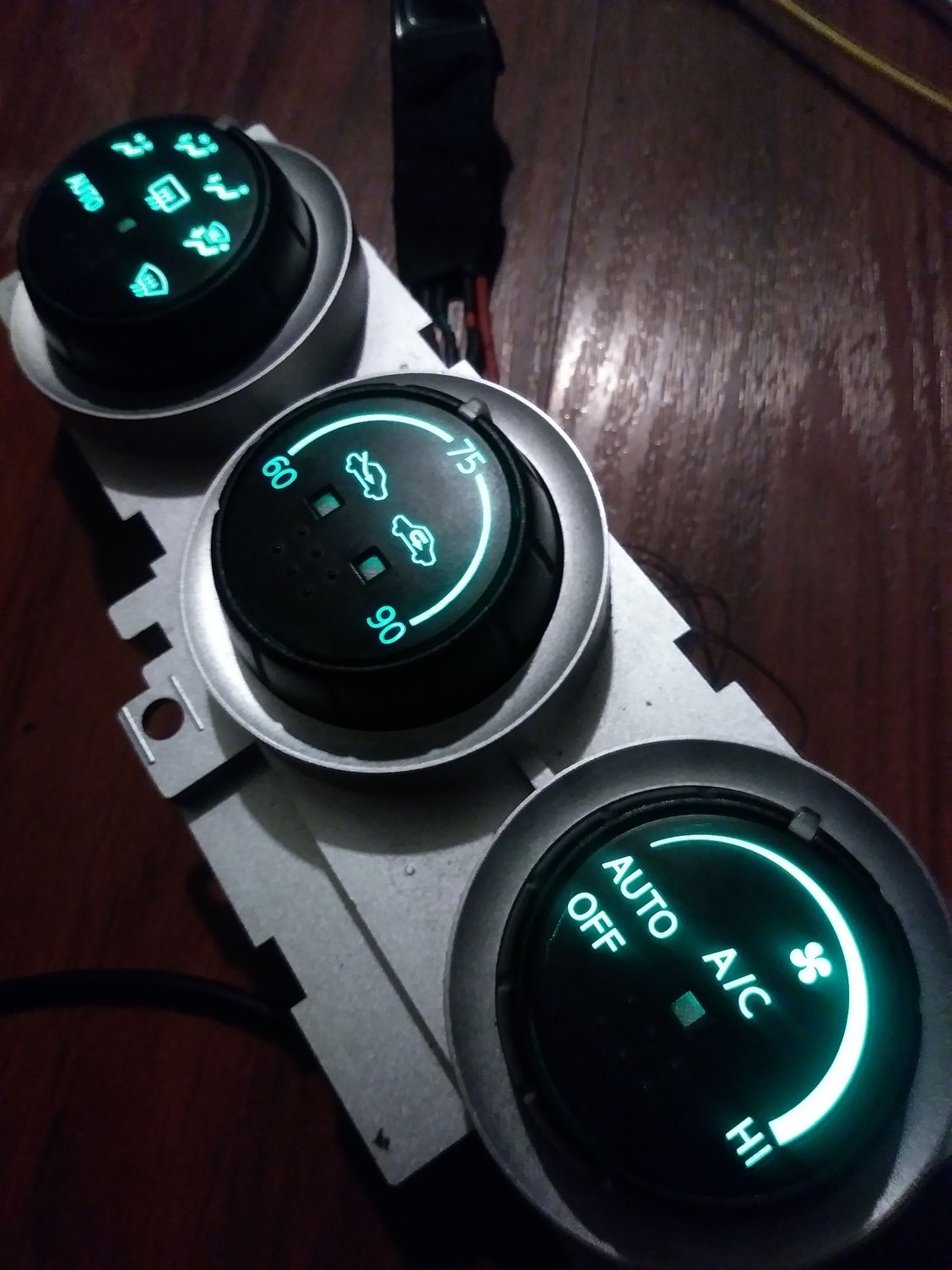

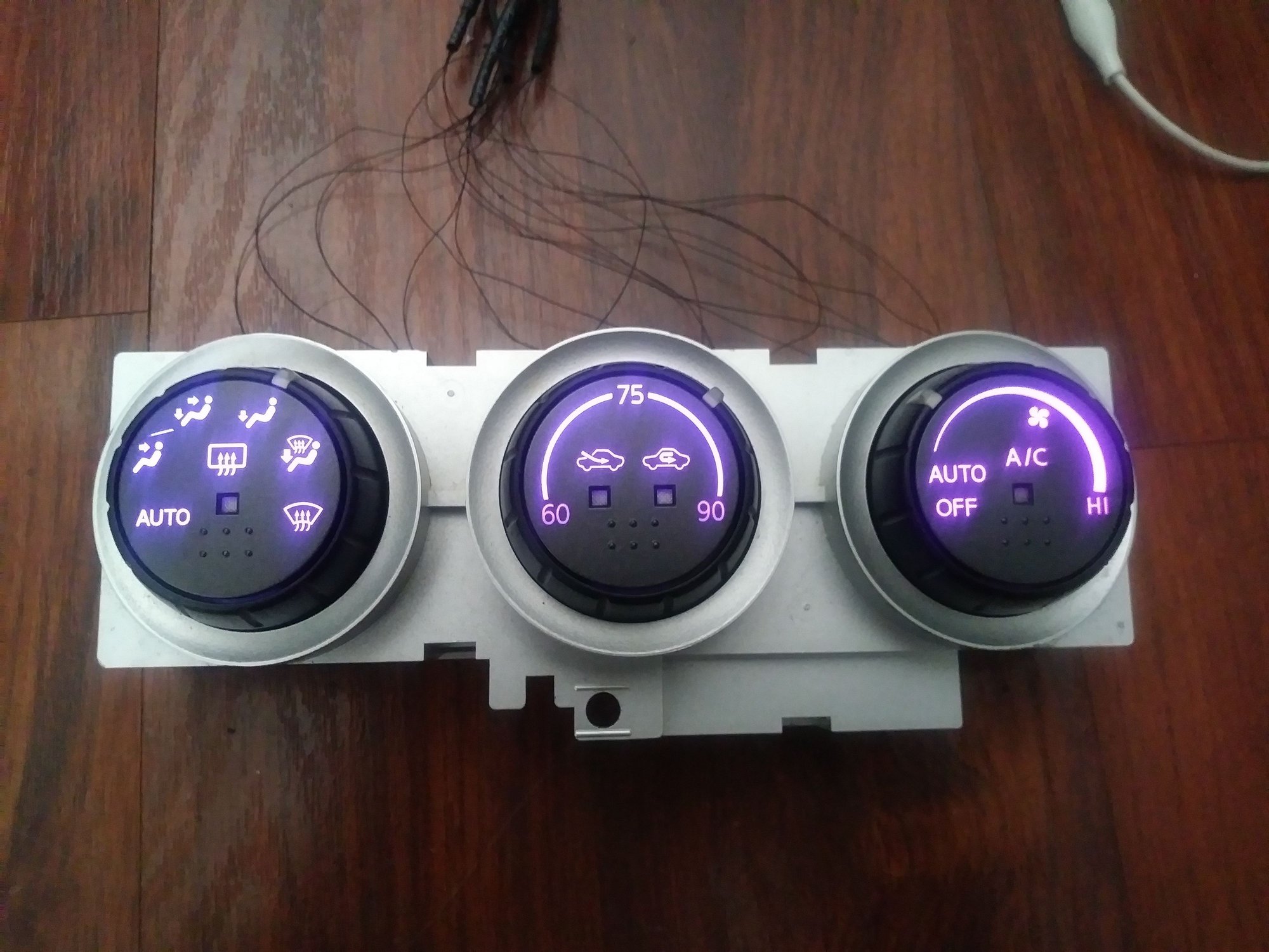

I take regular 5050 RGBW LEDs and solder leads to each negative pin then I solder a single lead that spans the positive pins(because the controlers are common ANODE) I bunch up all the wires and run them out the screw hole closest to where the LED normally goes(you dont absolutely need ALL the screws so utilizing the hole in the PCB board works well for routing) then I use silicone to attach the LEDs in place. Then I tie up all my ANODEs and all my RGBW wires seperately. Then I use 2 1/2watt 200ohm resistors in series for each RGBW line. Solder a 5pin connector to the 5 leads in order of your controllers outputs (in this case its +RGBW).
Connect your controller and make sure everything works. I like to use Bluetooth controllers. Then In place of all other LEDs I put White ones (white indicator points on the ***** and white indicator windows blends much better with and RGBW set up as White goes with any color well). Then I take the ***** and bore out the hole where the RGBW LED fits in. The stock hole is too small. It is easily bored with a dremel or something and the ***** are durable. Just dont go overboard. I then cut all the pegs off the inside of the back plastic cover (so the controller and wires can bunch up and be enclosed inside). I actually took the Bluetooth controller apart and wrapped the module in shrink wrap for space purposes. Route a wire out the back of one of the holes where you cut the posts. (The wire from the bluetooth that youll find a 12V source for) After that you put it all back together. Fund a good 12V source and boom you're basically done. Piece of cake haha 🎂

Hahah its all about thinking outside the box. Anything's possible. There's no interior piece that can't be modified to an RGBW set up. Room restrictions don't apply if you use a small enough LED and wire

Actually I usually use multiple Bluetooth controllers of the same app ( this way it can act as a central because you can control them individually or unison if its the same app.) If I were to use only 1 controller I would have to route wayyy too much wire and it would be a NIGHTMARE. Imagine trying to route from door switches to the center console and from everywhere else to a central point. Much easier to just use multiple controllers
