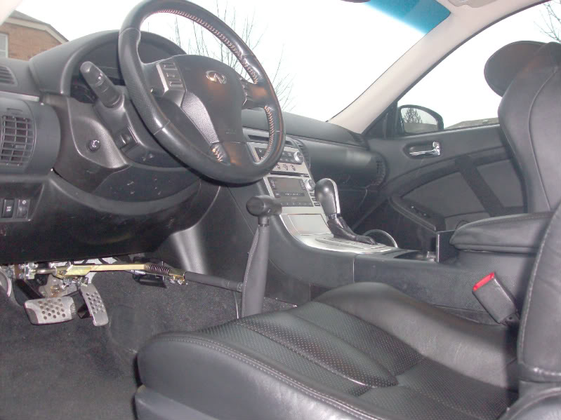

When I get thinking about something I can't stop until I figure it out. I decided to go over to the dealer today and have them print out some schematics for both the manual and autos. It looks like the linkage going the the rear wheels is exactly the same. The only difference is for the auto, there is a longer cable running up to the pedal instead of a short one that runs to the hand brake.
Now all I have to do is track down a center console, gearshift shroud w/hazzard button, and the hand brake and cable. For sh*ts and gigs, I had the dealer look up prices...$1600. haha That sounds about right. I will let you guys know how it all works out and post up the schematics once I have access to a scanner.

Thanks for the info. You are exactly right. I just found out these two side panels to the radio are different on the 6mt than the 5at. With that being said, there are also several other differences that make my idea a potential failure. The entire center console to the 6MT sits about an inch and a half lower than the 5AT console. I would have no problem putting the whole thing in but the problem is that the auto shifer still sits up too high...I wouldn't be able to put the 6MT bezel in.
I figured all this out in the dark last night so I may take a closer look. I already have a 6MT center console so it's worth a shot. There are still a couple other issues I am dealing with though. The arm rest for the auto is a lot longer than for the manual. Since I use a hand control, this longer arm rest is key for comfort because I can rest my elbow on it and drive. I would lose that with the 6MT console.
