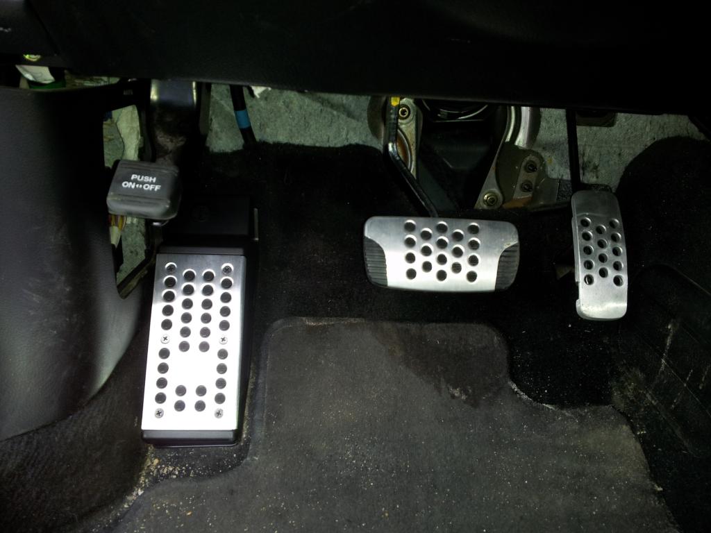

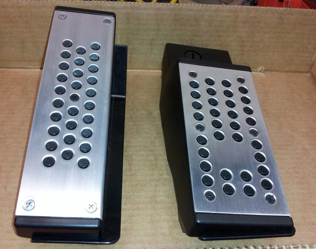

This applies to the 03-07 coupe and 03-06 sedan.
I ordered the OEM sport pedal set from Phil at Grubbs. When I received them the dead pedal didn't fit very well and looked out of place. Looked like it was for a manual trans. Phil was under the impression the manual and auto dead pedal were the same but after a little digging he found the one for an auto trans.
I had seen others complaining about the fitment of the dead pedal and chances are those people have a manual one installed on an auto.
Left pedal pictured is the manual (part # 67840-CD01A)
Right pedal pictured is the auto (part # 67840-CG010)
Also pictured is the stock pedal setup, sport pedal setup and the sport pedal setup with the manual dead pedal.
