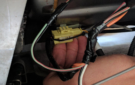

I fixed my passenger airbag light issue by wrapping zip ties around the connector. There's a TSB for the issue and the fix involves removing and replacing the connector, however the 2003 and maybe 2004 sedan wasn't included. The zip tie trick has worked for me for over a year now.
Attached Thumbnails Anyone fix their flashing airbag light by replacing the seats?-2017-05-15_18-18-04.jpg
