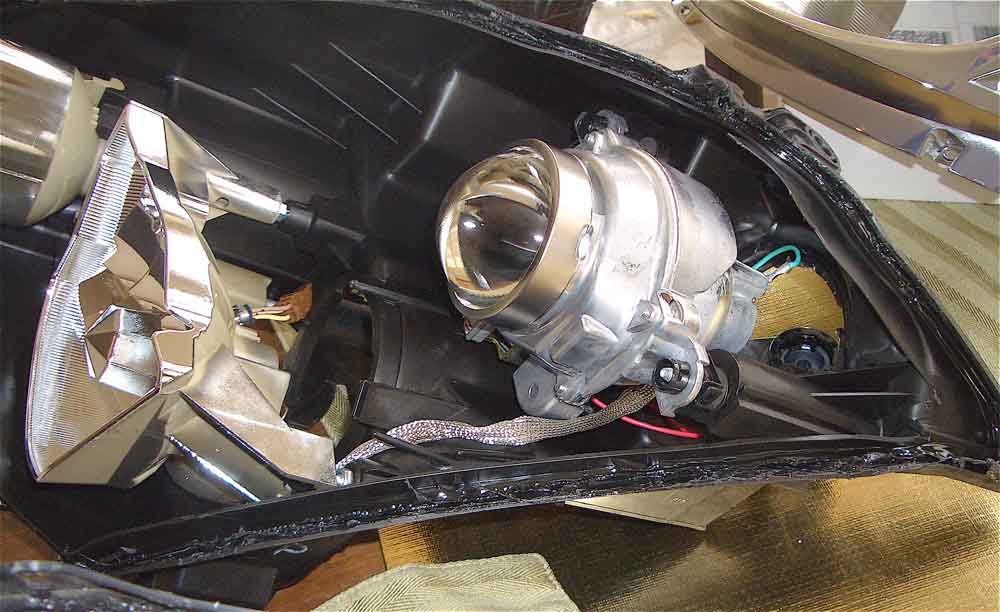

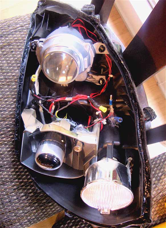

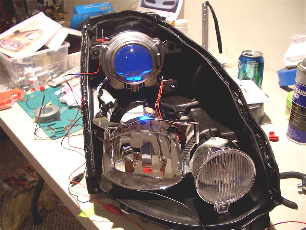

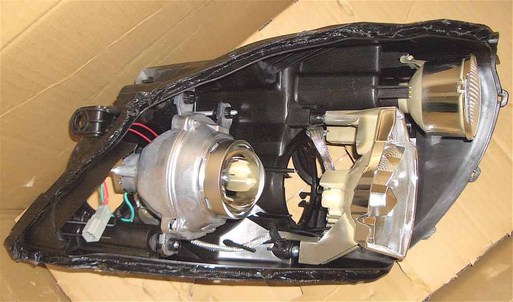

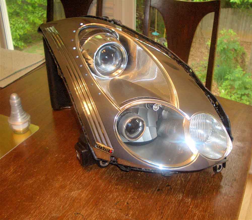

Originally Posted by chanycrazy
just wondering^^;;

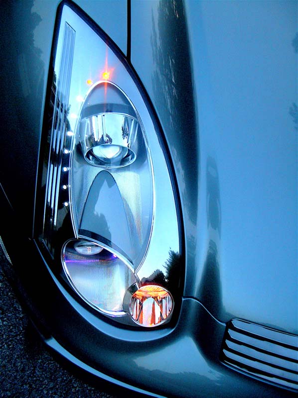

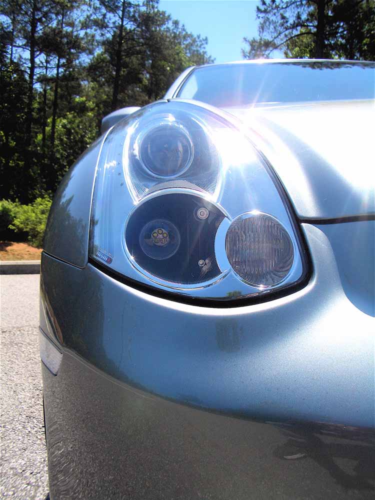

NO...the projector housing is in the way.
It goes all the way to the outside of the light bexel. When I had my 06 headlight apart I was going to put a 12" LVF there, but not enough room.
So I just put some leds up the outside of the light bezel (2nd time taking these apart to add the lower projectors & change up some LED's).
See 1st pic, outside top LEFT HID frame & mounting bolt is in the way.
4th pic is w/headlights off & camera flash.
Last pic w/blinkers on...
44 LED's per side, including...
7 White LED's following the outside outline of the top light bezel,
5 White LED's in a gatling-gun grouping mounted in a 2" PIAA Projector
1 25/LED 3156-A25 Amber Turn signal bulb
3 Purple LED's in the HID Projector
1 Purple LED in lower fog light bezel
1 Amber LED in lower fog light bezel(in the 168/194 city light spot)
2 Amber LED's above HID bezel
All White & Purple LED's come on as Parking lamps...

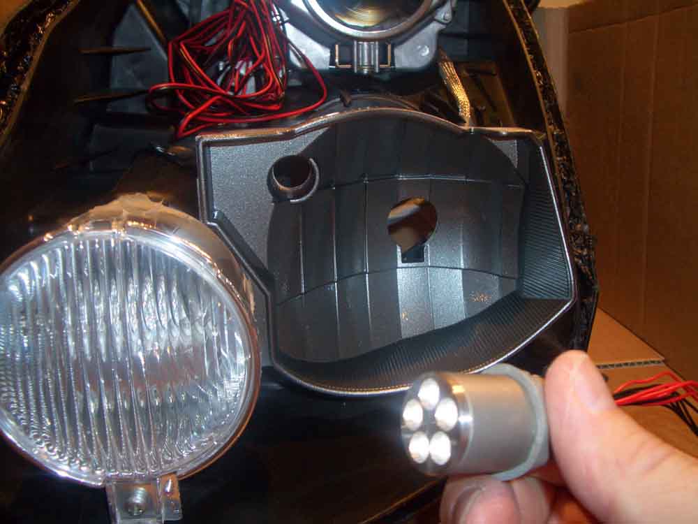

Do you have anymore pictures of those open '06?

Just kidding with ya man. These are all I have, hope it helps...

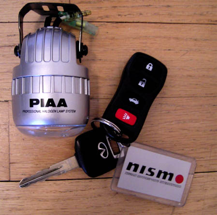

RugRatCoupe. Where did you get the smaller 2" projector?
Also do you know what other brand or other 2" projectors are out there?
Thanks

I used PIAA 002 TURBO-L /2" LED Projectors. These are accent Lights I used w/my parking lights. Since they're LED's they don't light up the roadway like a true Halogen or HID Projector does. Can't think of any other 2" Projectors other than the 03-04 350Z's.
I gutted the PIAA TURBO-L's LED's and replaced them w/ Five 6000mcd LED's in a gatling-gun arrangement, much brighter.
