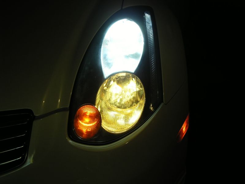

i change my fog lights 2 week ago.. due to the fact that my car was pretty low i use a jack an jack up the car which give me clearance pull out the plastic screw an pull down the plastic mud guard, from there you should be able to reach the plastic cap that is protecting dust from getting in fog lights turn the cap counter clockwise, once you remove the cap there is 2 lock pin inside that hold the blubs in place pinch those lock pins in an the blubs should go lose.. after that just replace it with an aftermarket blubs..put everything back an do the same to the other side... btw i didn't have to take my wheels off took me 30 min for both side
Attached Thumbnails Fog replacment Question?-kif_2566.jpg   Fog replacment Question?-kif_2568.jpg

Umm, aren't those pics of the coupe's headlights? We're talking about the 07 Sedan here.

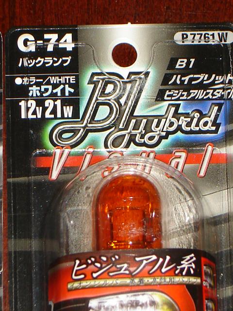

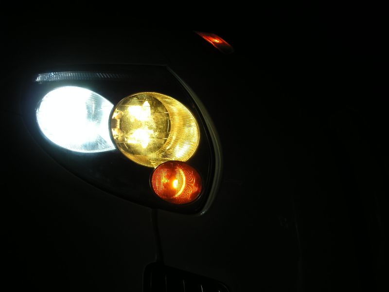

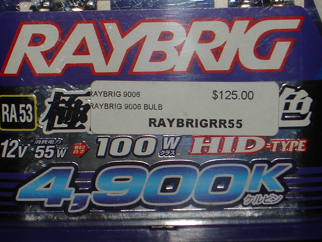

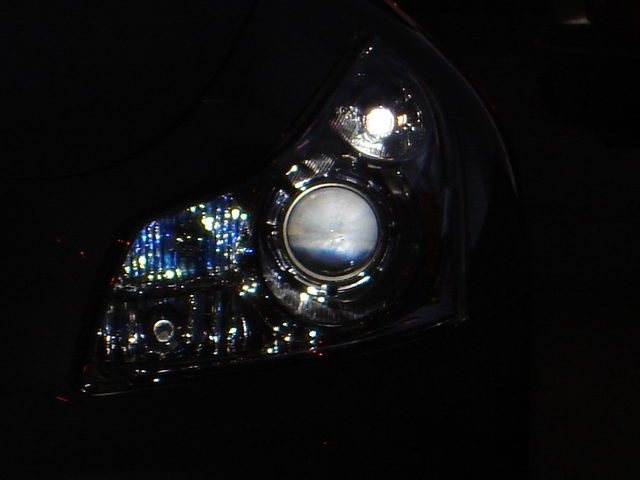

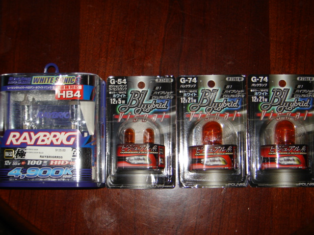

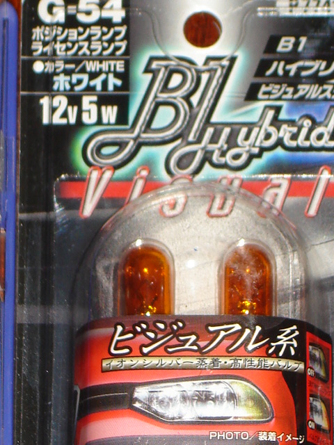

Here are the pics of the bulbs that I bought in replacement of the OEM bulbs which are now in the packaging pics here:
Here is a Pic with the parking lights on only also.
Attached Thumbnails Fog replacment Question?-dsc02280.jpg   Fog replacment Question?-dsc02283.jpg   Fog replacment Question?-dsc02286.jpg   Fog replacment Question?-dsc02287.jpg   Fog replacment Question?-dsc02272.jpg
