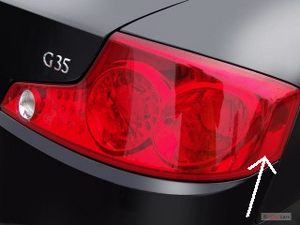

Just noticed that this light on my drivers side was out:
Is that considered:
"Rear sidemarker
194"
If so, I have my 194s from my side corners that I replaced with LEDS, can I use them there? Same brightness/color?

Yes, it is. And yes, you can.
