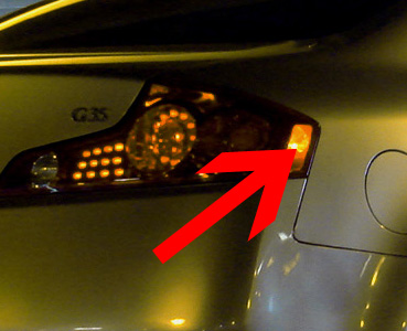

Does anyone know how to replace a rear side marker light (technically, an LED, according to my manual)? One of mine has gone dead somehow, and I simply want to replace it with another factory LED. I just called Infiniti and they said the only way to replace the rear side marker lights is to purchase an entire new light assembly (>$200). This doesn't seem right. If anyone is willing to offer SAFE directions on how to replace this LED, I'd be willing to pay them for that information. Thank you!
So there is no confusion on what light I'm talking about, please see the attached photo.
Attached Thumbnails I looked, but cant find DIY for Tail Light removal?-rearsidemarkerlight.jpg
