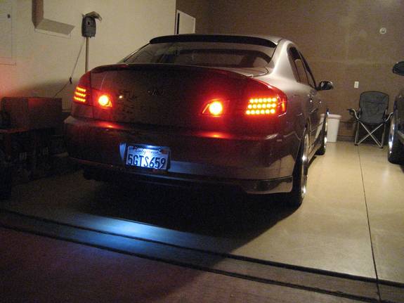

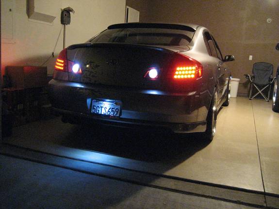

sedan reverse lights ALSO used as parking lights ?? how was this done ????
anyone know how there is a red and white bulb in there at the same time and how the wiring works to altenate between them ??
looks pretty sweet to me
thanks
Attached Thumbnails sedan reverse lights ALSO used as parking lights ?? how was this done ????-g-tail.jpg   sedan reverse lights ALSO used as parking lights ?? how was this done ????-g-tail-light.jpg   sedan reverse lights ALSO used as parking lights ?? how was this done ????-g-taillight.jpg

I don't know exactly which bulb he used, but the concept is simple. Swap the single filament OEM bulb for a dual filament LED bulb with a similar shape and cut and solder onto the OEM harness and tap into the parking lights.

Yep that's all you need to do. I would bet it needs some custom work to get the bulb in place but overall it's an easy mod. All the wires you need are right there.

it's called a switch back bulb...
http://autolumination.com/7443_7440.htm

the application you are looking at is custom. but basically it's the same exact thing just wiring it to what you want.

he could've used two sets of LEDs.
