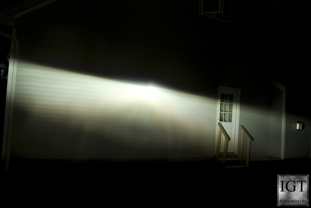

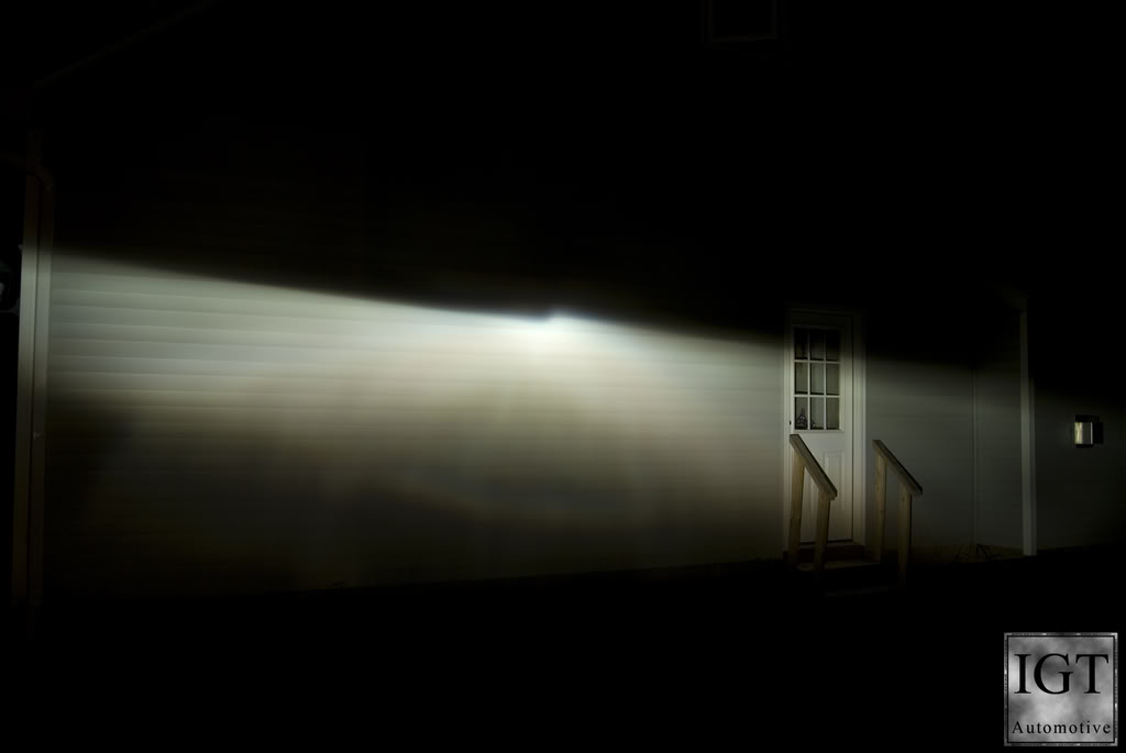

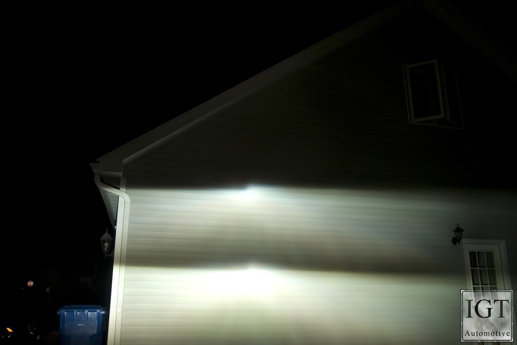

You won't find 50 watt bulbs in 5000K, all aftermarket kits are overdriven 35 watt bulbs. This means it runs hotter than stock or when a DL50 is used, it will burn the chrome off your projector insides.
OEM

DL50 with 55watt ballasts

Top OEM Bottom DL50
