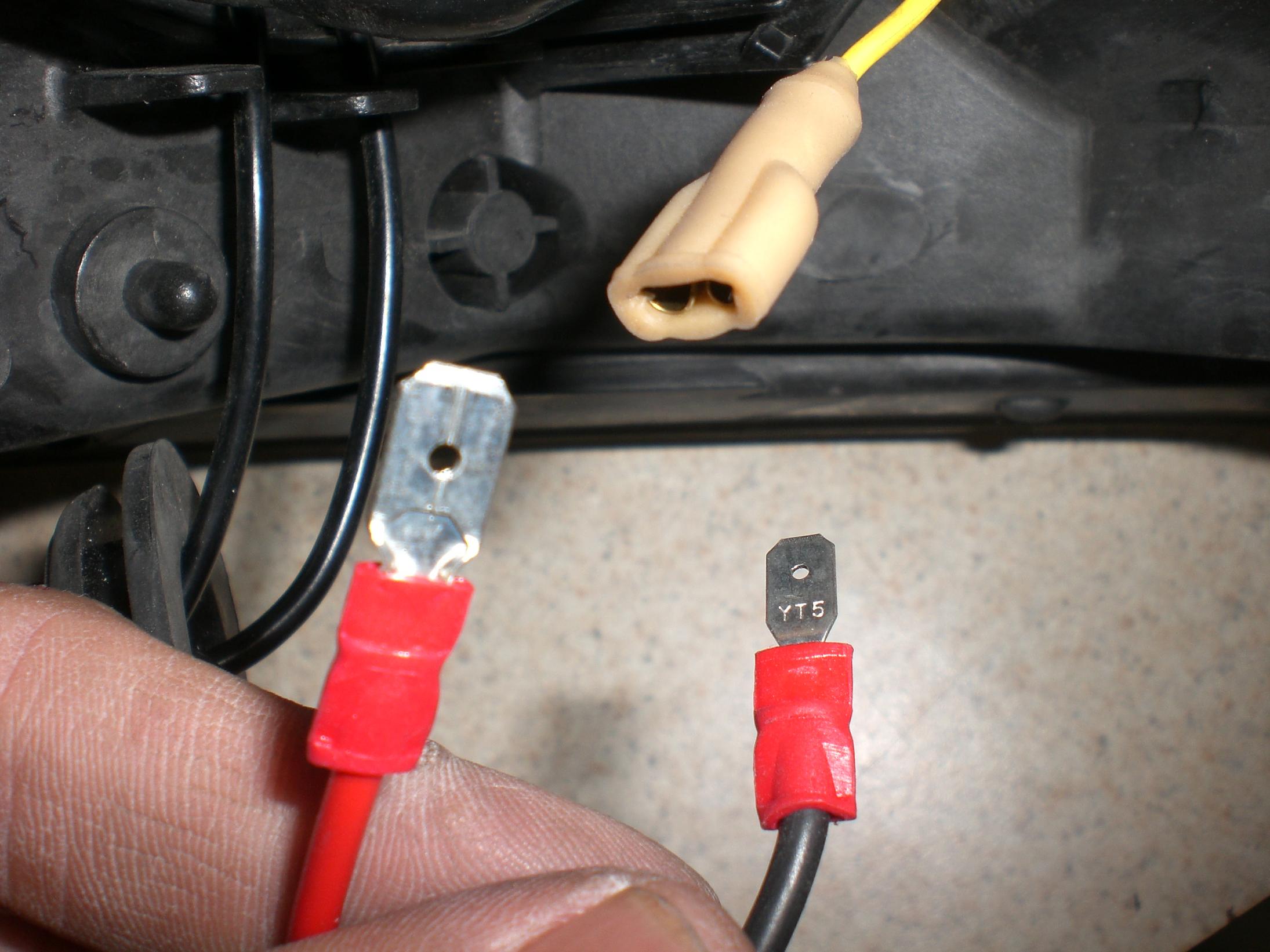

I just received my DDM H1 35 watt HID kit for my foglights today...but ran into a slight problem, i have no clue where to plug in the polarity wires, since the H1 bulb has only 1 polarity plug in port. Any advice fellas?

picture of the HID polarity wires and the OEM polarity wire

Black with black and what ever other colour wire you have left goes together.
Old Dec 29, 2010 | 01:21 AM
sTeadFasT96's Avatar
Posts: 866
Likes: 16
From: Kennesaw, GA
I was very confused also. It took me a while to figure it out. What you have to do is remove the ground wire (there is a black wire,with a black rubber wrap around it, that's attatched to the actual headlight on the inside and you gotta kind of muscle it out) and plug the negative spade on the HIDs into that then the positive goes into the regular plug.
To be honest I'm not sure if there's any reprocussions doing this (removing the ground in the headlight), but I've had no problems so far.
Just remember, AIM YOUR LIGHTS when you're done.
