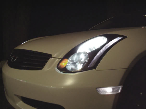

The OEM HID bulb is usually 4100K...That will give you the most light and distance for safety. Many have changed them out to 5000K color match or 6000k with about a 20% loss of light. 8000 will have a nice look, but you will be sacrificing a lot of night distance and vision, especially in the rain.
That is your choice, I'm not here to preach safety to you.
The LED's should all work fine....remember, they are very sensitive to heat build up, so they may not last as long as an average compatible bulb.
The H1 OEM bulb is usually 3000K.....they are usually 55/65 watt. I would not suggest going with a higher wattage like 90/110....they will give you problems.
So, As long as you keep within the wattage range...any of the aftermarket bulbs will work fine. Keep in mind, you lose light output as well when you go with a higher Kelvin temp on Halogen bulbs as well.
I had MTEC 4350 bulbs which matched the OEM HID's pretty well, but did not light up the road for any distance....so they were show and not function.
I put in OSRAM Night vision bulbs....they have a light blue coating and match the OEM HID's very well once the HID's are up to normal temp.
I think any bulb in the 4100 to 4500 should match pretty well.

I used PIAA extreme white 168/194 Bulbs in my clearance light and side markers....they matched the MTEC's pretty well.....

ps. your whole headlight looks pretty coool , all white color matched pretty well !!
Thanks for your time and advice again!! i will google it up myself
