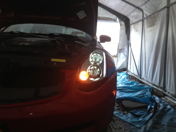

It's actualy easier to do a quad projector retrofit on 03-05 headlights because you have more room on the fog light area of the shroud. I just did a quad retrofit for a member here on 03-05 lights. If you're looking for MORE light on the road then a quad retrofit WILL give you more light, simply because you will get the combined light output of 4 projectors. The retrofit I did is even wired so that all four projectors stay on when the high beams are on, so if this member goes on some dark country roads, he's going to have enough light! Like another member said, going with a lower temperature bulb will give you more light, so instead of going with 6000K bulbs, consider 5000K or even better 4300K. The lower you go the more light you're going to have on the road.

It may seem like 6000K are optimal but they're not, (based on Philips datasheets) and avg. 4100-4300K bulb (85122) can produce 3100-3400 Lumens, while a 4800K (85122CM) goes down to 2800 Lumens and 5800K (85122WX - Ultinon) goes down to 2400 Lumens. Like I said, the higher you go the less light output you will get.
If you're going to do quads, there have been guys here that have done quads on 06 lights and they have used the 06 projectors on the lower part of the lights. I haven't done quads on 06 lights, so I can't give you any ideas on what the best way would be for mounting the projectors on the lower part of the lights.
