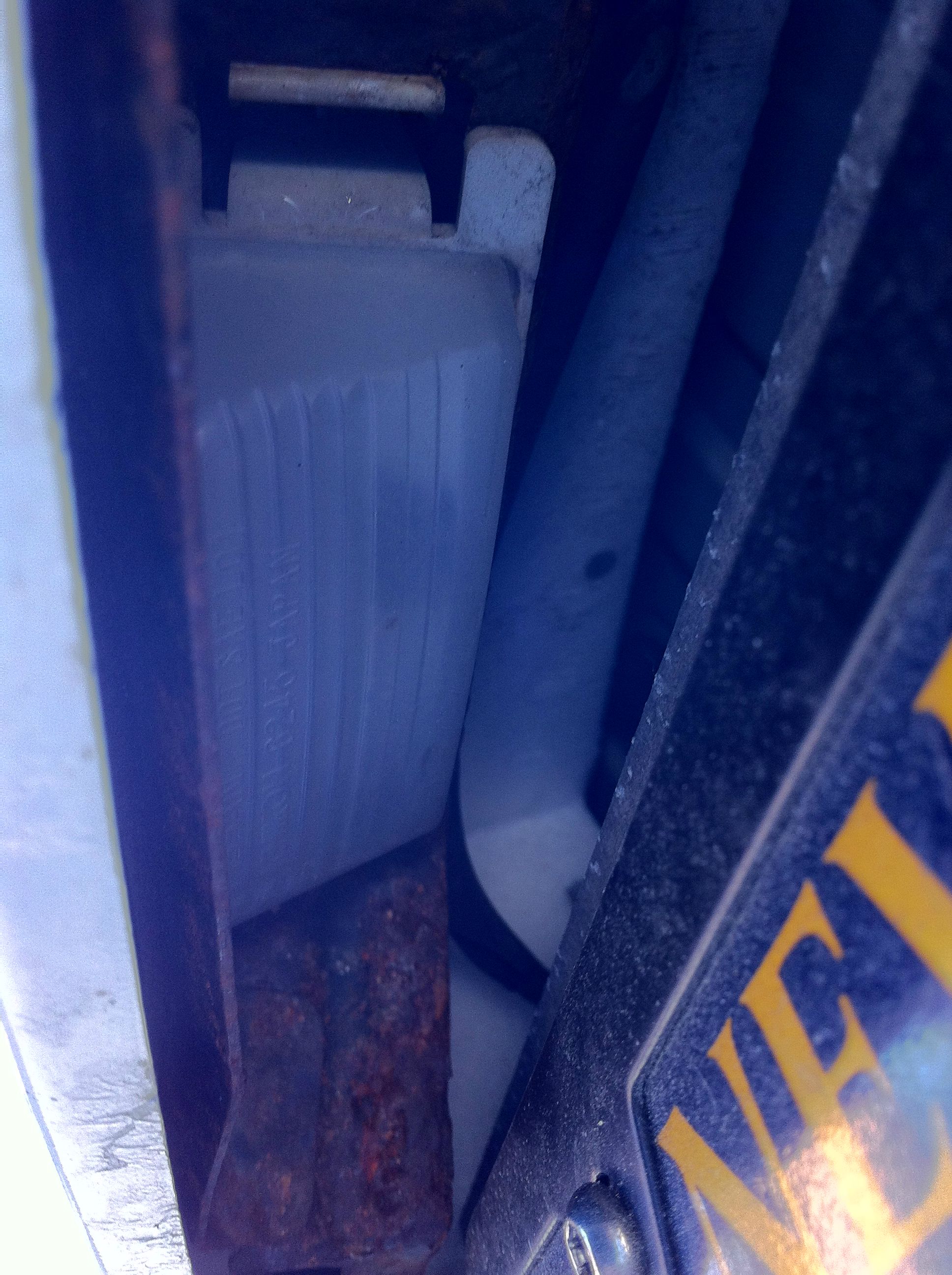

How to pop out license plate light housing?
What am I suppose to be pressing in with the flathead?
Old Dec 12, 2013 | 02:42 PM
Ogee's Avatar
Joined: Sep 2012
Posts: 512
Likes: 76
That metal prong at the very top of the pic with a shadow in the middle of it. Press that towards the light housing. There is another prong on the other side. Squeeze them towards each other and pull down. Does that help?
So push that part towards the light housing?

Yes, but there is an identical one on the other side and you have to squeeze them together towards the housing at the same time and pull down slightly, it should pop right off.

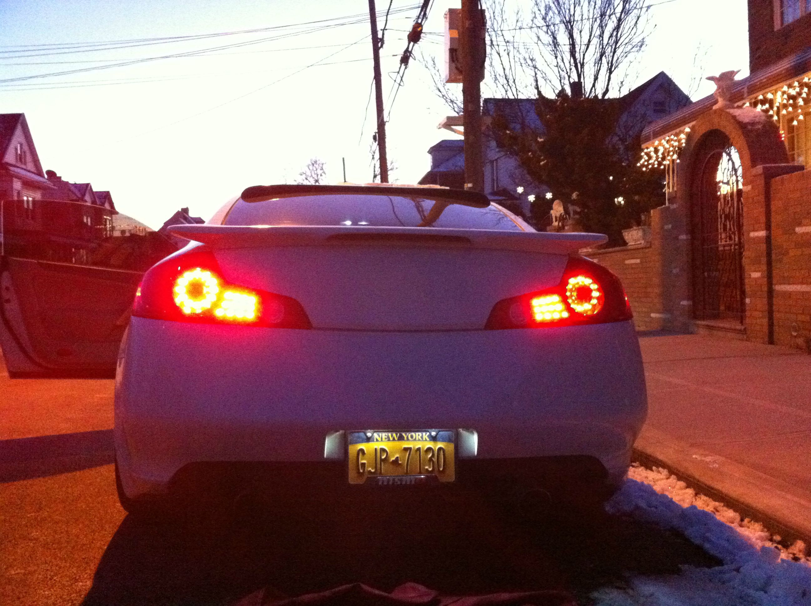

Thanks so much once again man lol, I gave it a try and got it to work(hands are literally frozen now though) 25 degrees here in NY haha
finally got my bulbs on it
