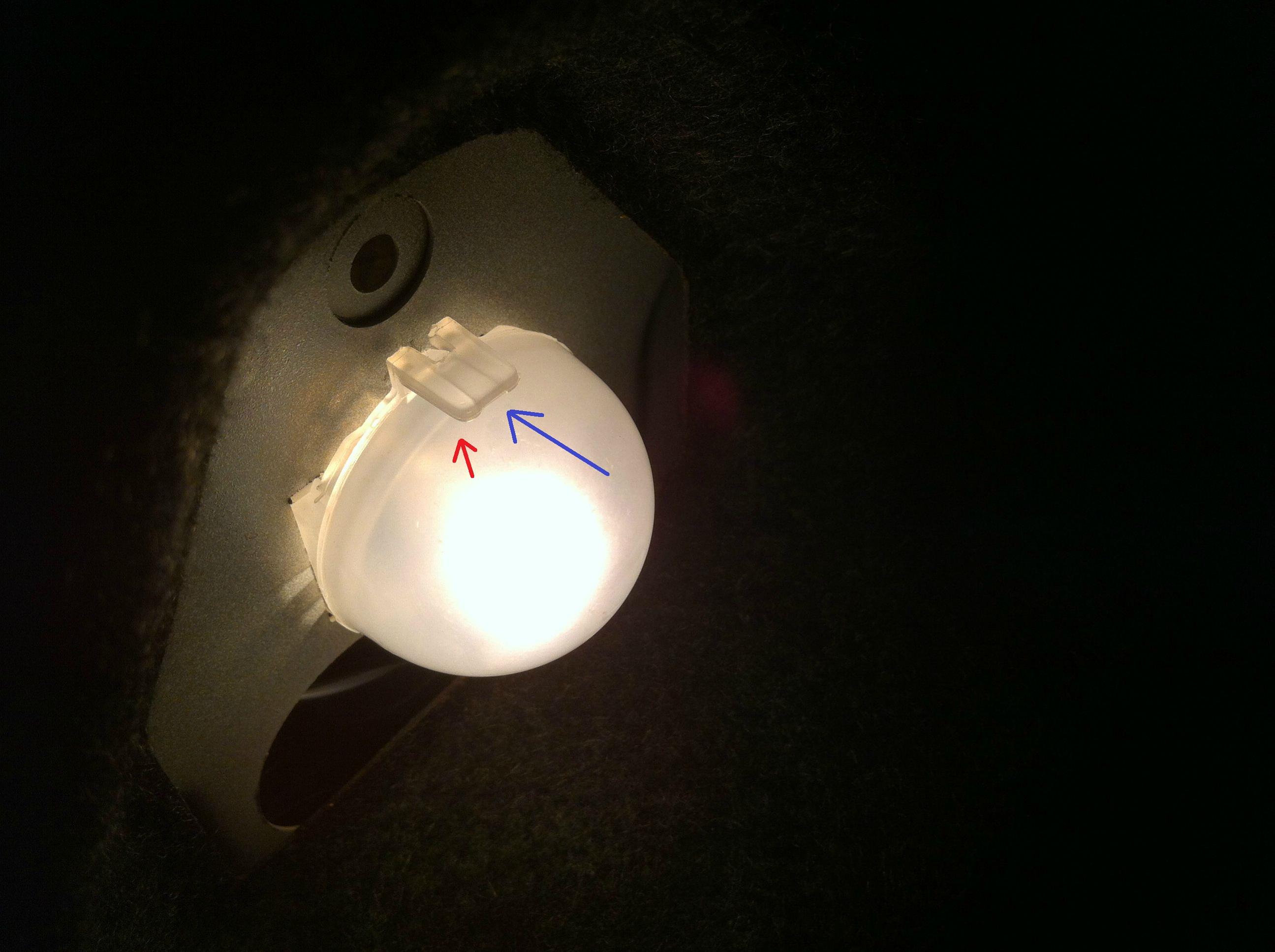

How the heck do I use a flathead for this? Theres no room for me to work it.. I got it halfway off and I feel like its gonna completely snap. Idk where to pull from, can someone guide me? lol
Old Dec 26, 2013 | 07:33 PM
Ogee's Avatar
Joined: Sep 2012
Posts: 512
Likes: 76
Okay, so do get this thing open...
(1) Insert the smallest flatest screwdriver you have within reason in between the tab and the dome indicated by the blue arrow. Push it all the way down towards the "ceiling" of your trunk, but be careful cause if your screwdriver is not flat enough the tab will break off. Maybe try a butterknife unless its too wide?
(2) Now, indicated by the red arrow, use leverage to pull slightly with the screwdriver towards the tab which will release the tab from the dome. The dome is on a plastic hinge and you will now be able to access the bulb.
Hope this helps. Goodluck! its really simple once you get it open and see how the tab/clip works haha.

Cant say thank you enough! Finally got the time to do it today and it was easy as hell. Thanks once again bro

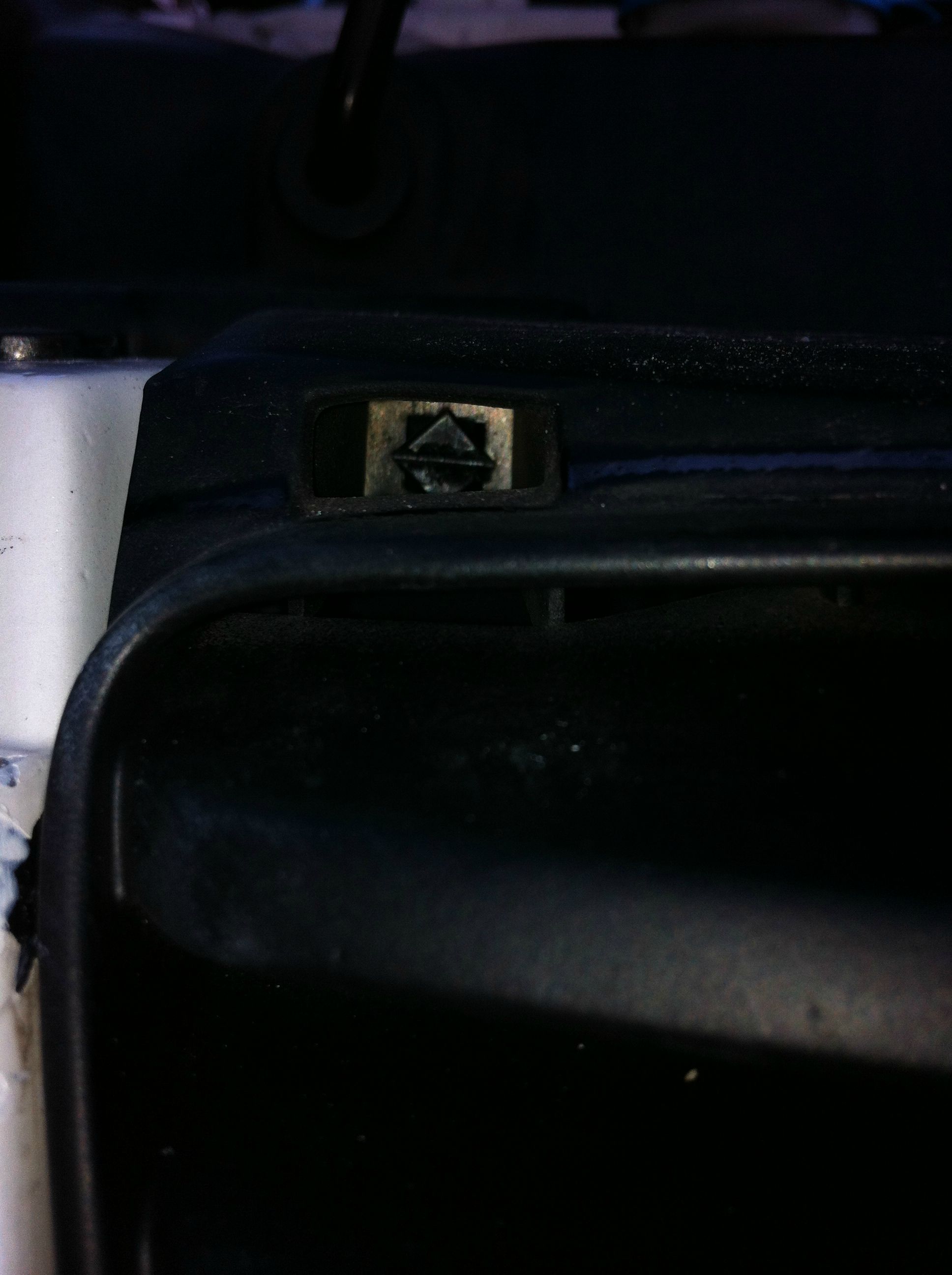

Finally got some pics lol!
So for this part, I need to take a flathead and turn it into a square so it can fit through correct?

Alrighty,
(1) Pop off the four plastic rivets holding the grill on. No need to take the one i marked off with a red x in the pic with or the matching one on the other side. Just the four that are attatched to the grill like the one i circled in blue.
(2) Now, you are correct, twist the squares with a flathead to allow the square to fit through the mating hole.
(3) The last and trickiest part is to push down slightly (red arrow) on the 8 metal tabs to allow them to slide through the slots in the bumper cover. So, minimal pressure needs to be applied both downwards to release the tabs and towards the grill (blue arrow) to keep pulling it free. The tricky part is to do this with all eight tabs without having one "go back in" or breaking off. Patience my friend Goodluck, and let me know if i can be clearer on any step cause its kind hard to explain with words and arrows lol.
