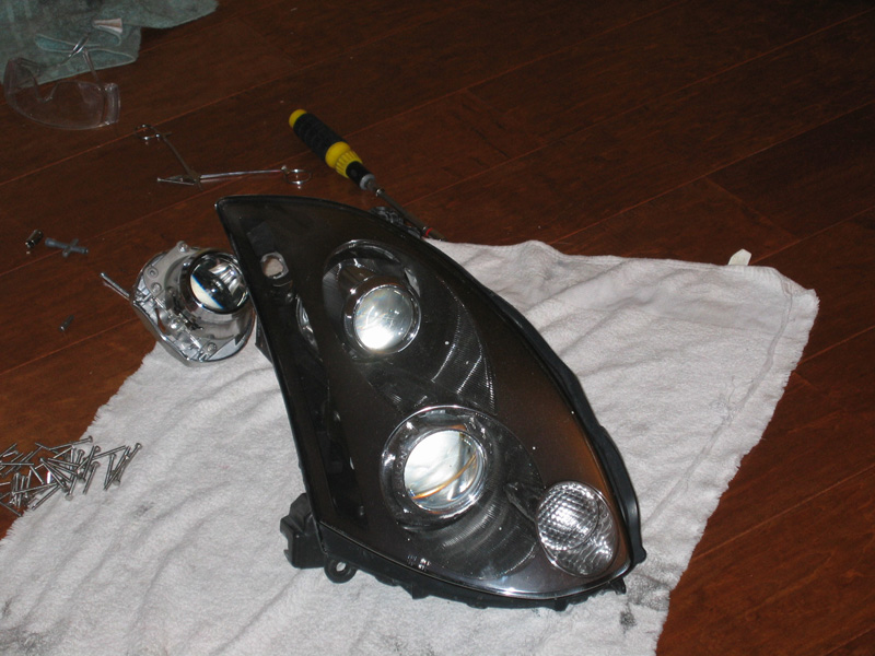

It's a work on progress for the 5th (!) revision of my retrofit, but here's a pic:
The low beams with the TSX projectors are done. The high/fog with RS6 bixenons need the shroud finalized and the wiring hooked up.
Very well done.. Approx cost and time to finish the job?
Old Nov 8, 2005 | 11:06 PM
Balzac72's Avatar
G SQUAD
Joined: May 2003
Posts: 1,060
From: Long Island
Ditto that! Whats your investment at this point?
Old Nov 8, 2005 | 11:57 PM
E_K's Avatar
E_K
Joined: Aug 2003
Posts: 1,846
Likes: 9
From: Toh-rensa,Ahteesia,Ahcadia,Montree Pak, Longa Beacha
So far it's:
$200 TSX projectors
$30 hidplanet shrouds
$25 two E46 3" shrouds
$200 RS6 bixenon projectors
$300 for extra pair of headlights with ballasts/bulbs.
$45 H4 harness that will allow both high (solenoid) and low (HID bulb) to be on at the same time.
$7 for an acrylic pane at Home Depot for the clear signals, with enough material left to do another 15-20 pairs of headlights.
2 months of time into it, creating custom sheilds for the TSX projectors, figuring out how to mount everything. I do about 1 hr of it here and there. It's just for my own car, so I'm taking my sweet old time. My goal is to finish it by early December.

Originally Posted by ISMSOLUTIONS
With all that time invested and the bucks, woudln't it be easier to pop in the '06 headlights and be done?
I already did a retrofit in Sept 2003, pretty sure I was the first to do so on a G35.
But I'm looking for a sharper cutoff with the TSX projectors.
Plus, if you look at the list of items, you'll see that there are a total of 4 projectors listed.
