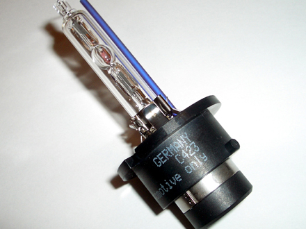

the small part on the right part broke. it kind of split and is loose now.
Old Mar 1, 2006 | 01:04 PM
papagz's Avatar
Posts: 2,199
in this case, its the blue part, mine is brown but im assuming same thing

so the brown strip broke off??

I WAS SO WRONG. it seemed as if the brown strip was completely broken, but they were just loose and cracked. I though that would be the problem. I took it to dealer who did nothing "because it was in an accident" went to the body shop who fixed my car and told them. Waited 3 hours for them to figure it out and finally figured it was the control module connected behind the light. so the bulbs were working fine. now i gotta wait 2 days until they ship the part and to install it. Shouldnt a body shop fix everything the first time you go there?? man im angry
