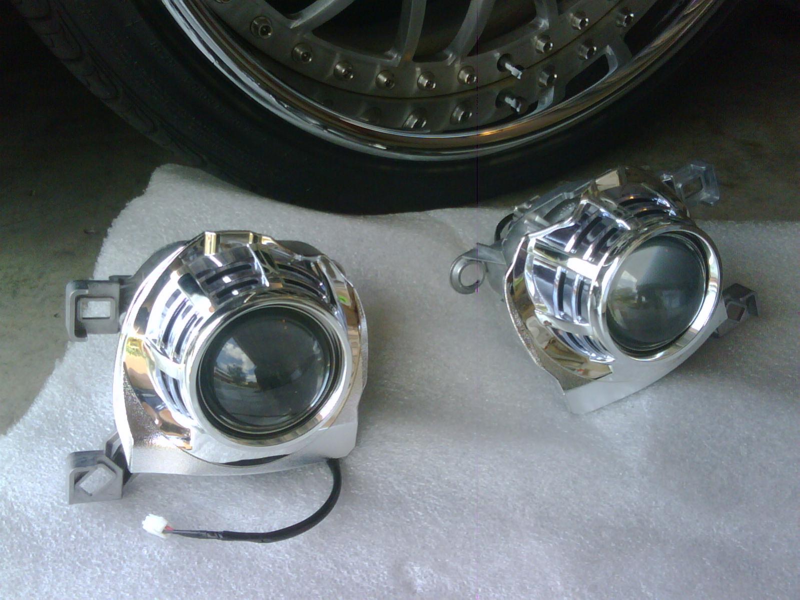

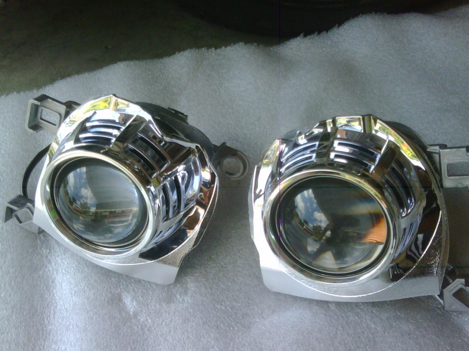

Almost new 07' g35 coupe projector lens for head lights, but also can be used to upgrade you factory fogs to have both projector lens top & bottom. If your very handy first must raise front of car and take off wheel, then remove the black cover underneath the fender, also must remove front grille to get to bolt, from front bottom of head light, then remove top bolt by the engine and remove the other two bolts underneath head light by the fender and bumper, when removing headlight you might have to squeeze it out throught the bumper and fender. When you have the head light completely out after disconnecting the wires, take it to the kitchen oven, then place it at 200 degrees at 4mins the last 1min, turn **** to 250 degrees, then try to pry open the housing with flat screw driver to remove the lens from the back housing if it still doesn't open repeat the steps again. Then disassemble the lights and remove the fog light and insert your new projector lens, after your done place housing back into the oven and repeat to make the glue soft again to attach the lens again. It takes patience if you have what it takes! Yours for $150 shipped - goodfellam3@bellsouth.net

can this mod be done on the 04 halogen headlights?

Well you will have to cut out the circles around the halogen a bigger so it can fit also you must to some modification to the metal housing which holds the halogen and fog together, other than that it should be ok

I would like to do this mod one day.. do u need another ballast to make them work?? Do u still have high beam??

You need two ballasts. They have to be spliced in to a power source. You dont have a high beam they work just like your fogs except brighter. Theres a DIY retrofit for these on the site and i believe its for the reflector headlights.
