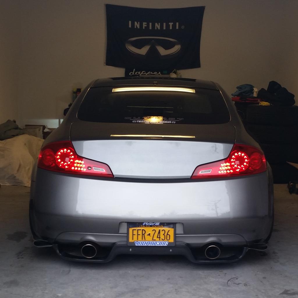

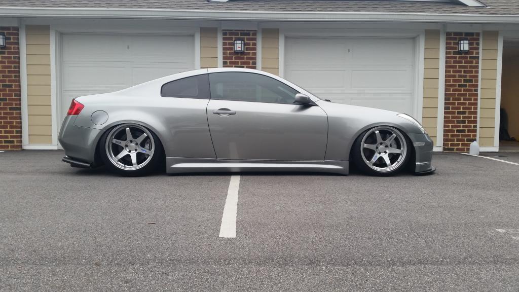

Bow can you give me the basic run down on how to install the mastergrade diffuser? I can't find anything on it.
Old Sep 7, 2014 | 02:25 PM
  #22339
BowWizzel's Avatar
Joined: Apr 2012
Posts: 1,087
Likes: 96
From: San Jose
I removed the bumper & fitted the diffuser to where I wanted it. Taped it down & marked the mounting holes for the main middle bracket. I also bent it a lil so it would hug the bumper better. Drilled the holes & mounted it as I think its a pretty long reach to mount it later with the bumper on. Gonna want to use washers. With it mounted with just the main bracket I taped the sides up & put the bumper back on. After that just get under the car & find a couple protruding bolts or bolt holes that are already there to mount L brackets to on each side. Then just line up the rear section under the car & drill holes to mount it up to the L brackets.
Old Sep 7, 2014 | 06:51 PM
  #22340
Shanes_G's Avatar
Posts: 6,869
Likes: 820
From: virginia beach
Bang bang

Nice...very nice. I'd like to see how well this works at high speeds.

I'll have to look them up. How's the grip with the 295's.
Old Sep 7, 2014 | 07:02 PM
  #22346
Shanes_G's Avatar
Posts: 6,869
Likes: 820
Really nice. Hard to break them free.

More power may be needed for that. Saw the diffuser on ebay for $269 plus shipping. Something else to get for my coupe. Do the rear mud guards need to be removed in order to install this.

You sure that doesn't touch when you air out?
