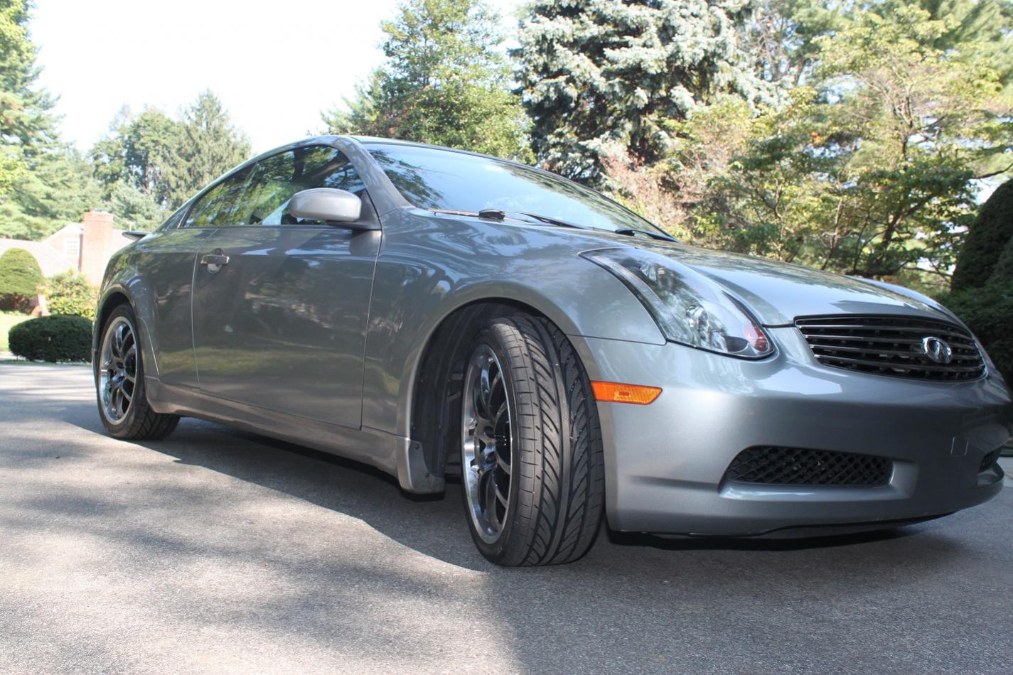

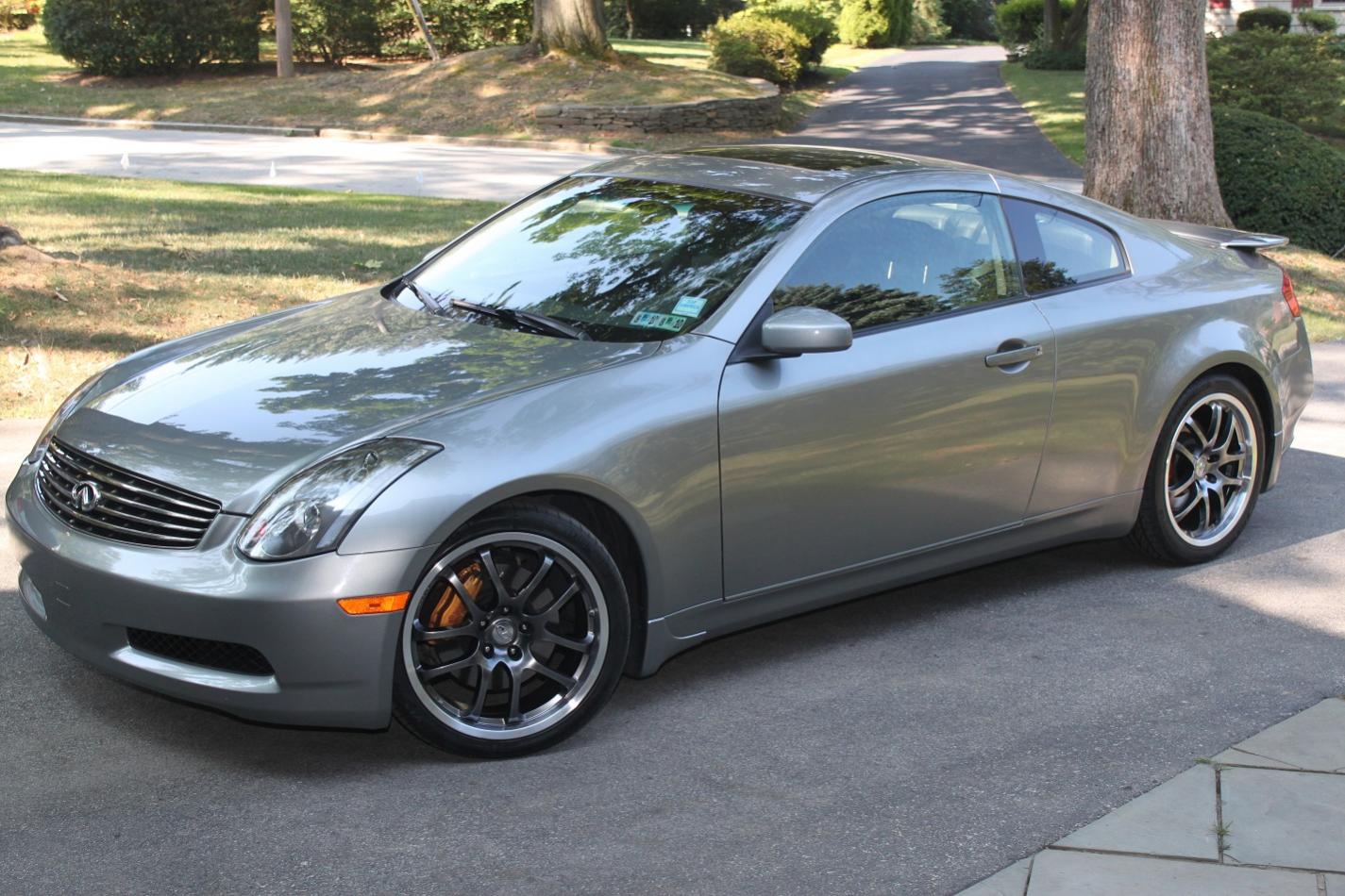

More pics...
Attached Thumbnails All DG Diamond Graphite Coupes POST PICS!-oemray5.jpg   All DG Diamond Graphite Coupes POST PICS!-oemray6.jpg   All DG Diamond Graphite Coupes POST PICS!-oemray7.jpg   All DG Diamond Graphite Coupes POST PICS!-oemray8.jpg   All DG Diamond Graphite Coupes POST PICS!-oemray9.jpg

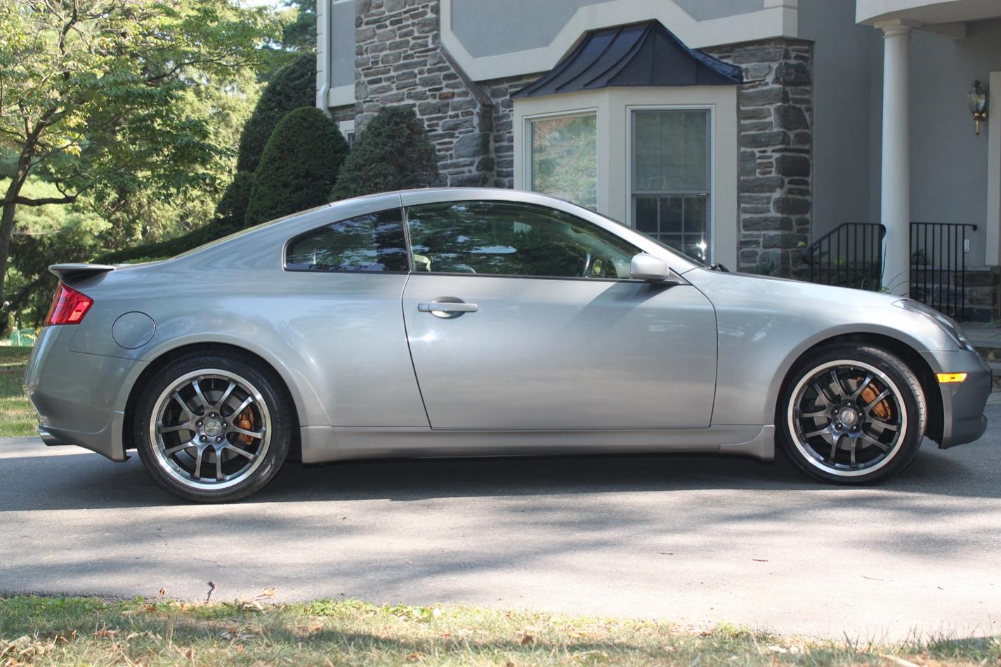

And a few more...
Attached Thumbnails All DG Diamond Graphite Coupes POST PICS!-oemray10.jpg   All DG Diamond Graphite Coupes POST PICS!-oemray12.jpg   All DG Diamond Graphite Coupes POST PICS!-oemray11.jpg   All DG Diamond Graphite Coupes POST PICS!-oemray13.jpg
