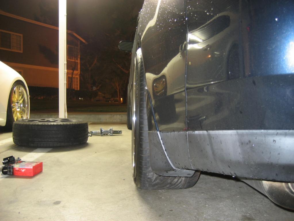

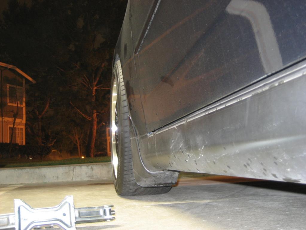

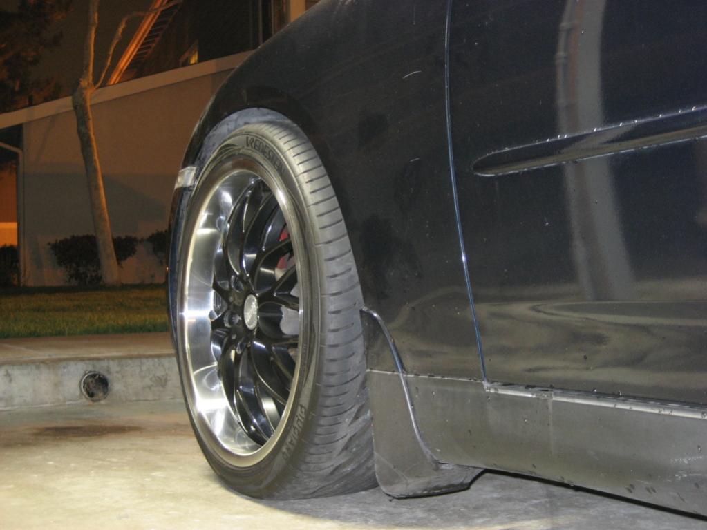

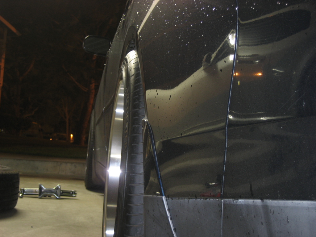

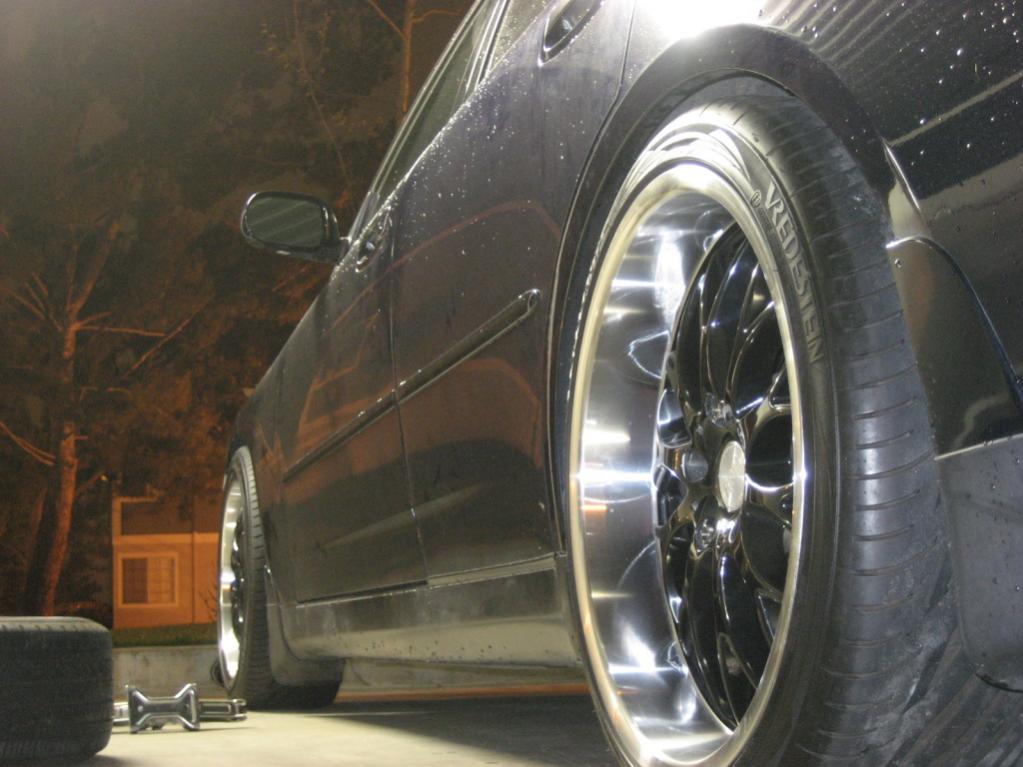

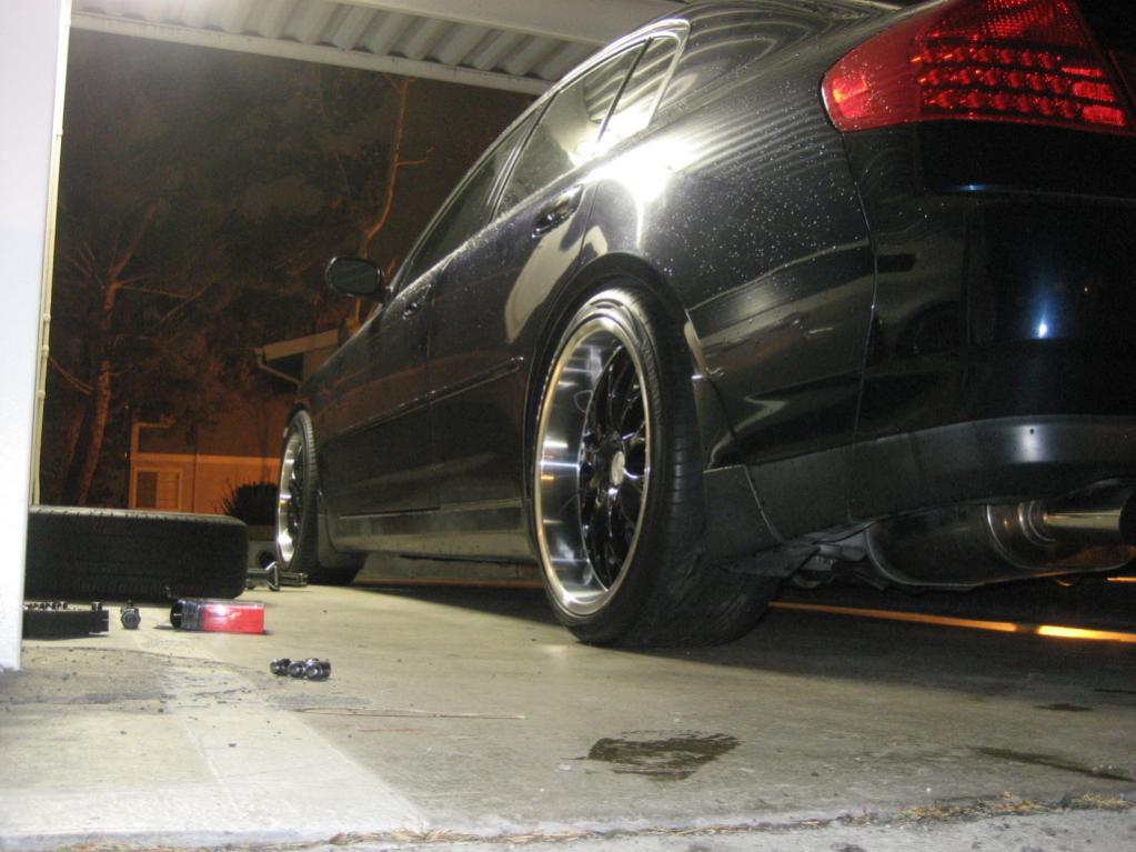

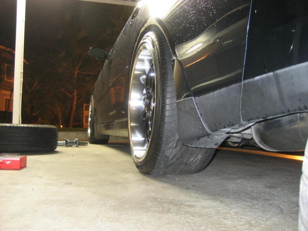

Hey guys, i went to test fit some rims and tires on my car today. These are the RPM 505 rims w/ vredestein Ultrac-sessanta Tires. I just loved the way these looked on my g. Im gona get this on my car in a couple weeks. My funds are short right now.
I am going to install these, front and rear camber kit, front slotted/drilled rotors, and get an alignment at the same time.
How do you guys like the wheels and tires. Any suggestions on the rears, they might rub.

looks good man. offsets are good, nice and flush!

You're gunna need to roll your fenders with those offsets. Negative camber would be helpful too

Either roll your fenders or get 1.5 inch smaller tires. I would roll with a 265/30 in the rear and 245/35 or 235/35 in the front. I know for sure your going to rub in the rear with the tire setup now. This setup looks like my old setup.
Looks like the current setup in the rear is a 9.5 +32 with a 275/35 tire.

looks good, may want to go with the tire suggestions or PM grant w/ specs so he can help you out, other than that-- super flush!

Im gona roll the rear fenders, and put negative camber when i get my alignment done.

what are the current tire size now? That looks way too fat to work.......even with rolled fenders.

looks way better than your painted stockers. tires look a bit too thick

275/30/19
its will work but he needs to roll the fenders flat and some negative camber
